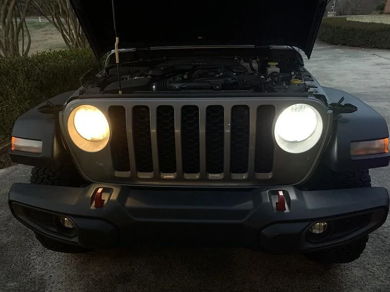

I am still at stock height and tires.
Well, then the next obvious answer is to lower your aim a little…
Damn, that sounds like some sort of de-motivational comment, doesn’t it?

I plan to get in there and drop them a bit. I don't like being flashed, but I do love how bright they are now and I can actually see on the back roads.

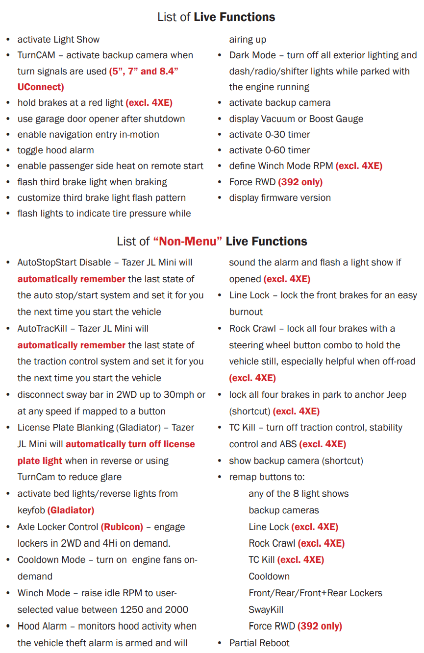

Get the JScan, it's cheaper than the Tazer. I'm using one on my JT, it does basically everything that the Tazer does but is under $100 for everything, I think I was at $93 for everything including the license to use it. Plus once you buy the equipment you can buy additional license for other vehicles and use it on those as well.
If you just want to change the bulbs and tire size, by all means go with Jscan. But it's not basically the same as the Tazer. The Taser has hardware (not just software like Jscan) that can do a ton of things that Jscan (or AlphaOBD) can never do. If you want these features as well, you pretty much have to go Tazer.
Jeep Gladiator LED Bulb Replacement - IT WORKS! 1644255677279
There is also the new off-road turn assist, which isn't on this list.

I ordered a Tazer to solve my LED foglight conversion issue.. One of the features I will use is the Winch Mode for the Idle. Mostly so that when I use the DC/DC charger on my camp trailer, I am spinning the alternator fast enough.

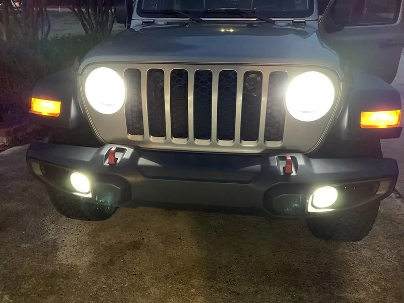

Confirmed Sylvania H13 Zevo LED fit and work with no bugs or flicker or bulb out indicators - the fogs are actually OEM LED fog lights from a 2-door JL:
Do the high beams work ??
