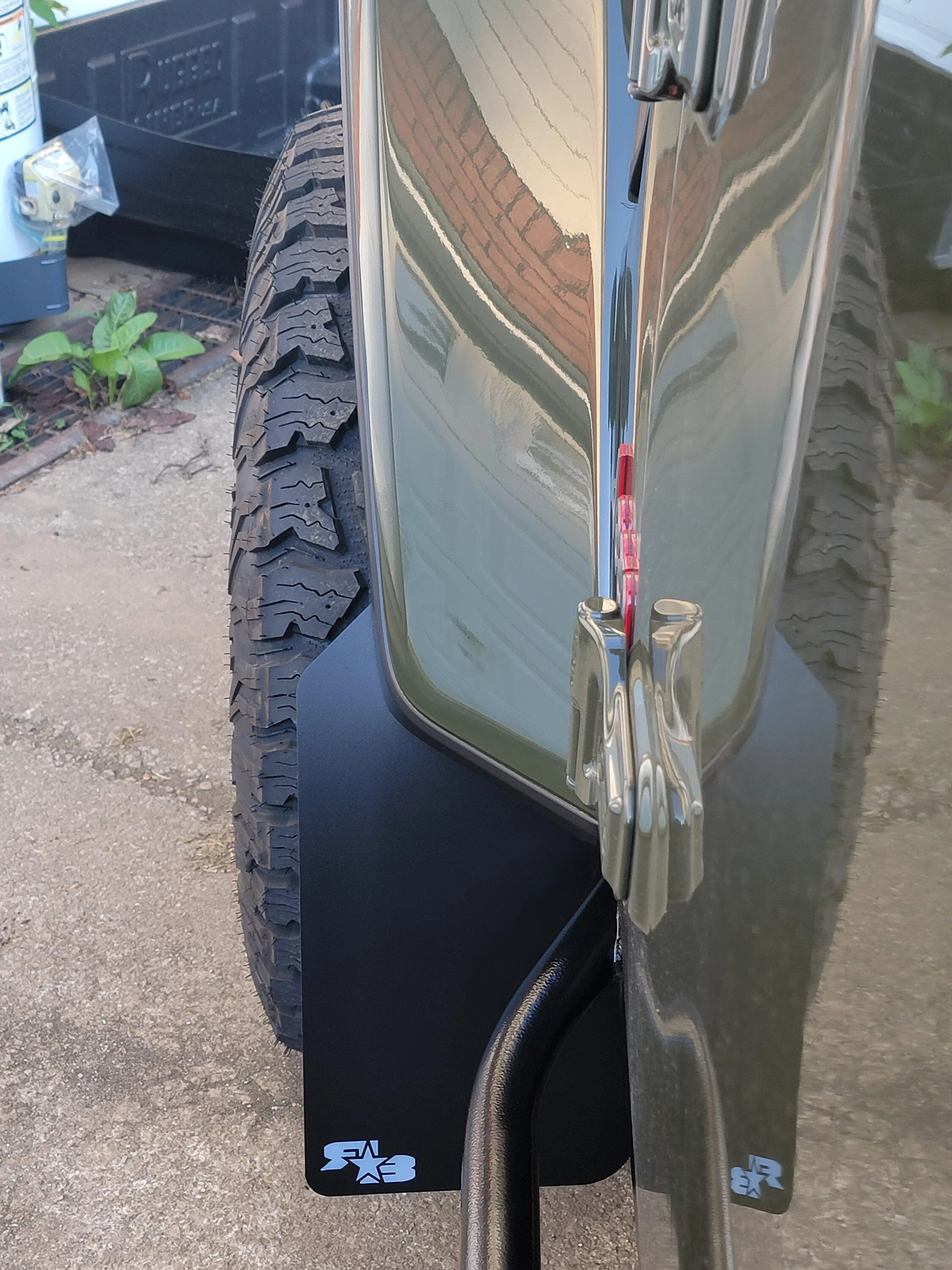

I only rub at full artiticulation and wheel turn. Mine are 13.50’s too so extra wide.
Did you have to add wheel spacers? I'm purchasing a -44 set of wheels and picking up the 37s this weekend.

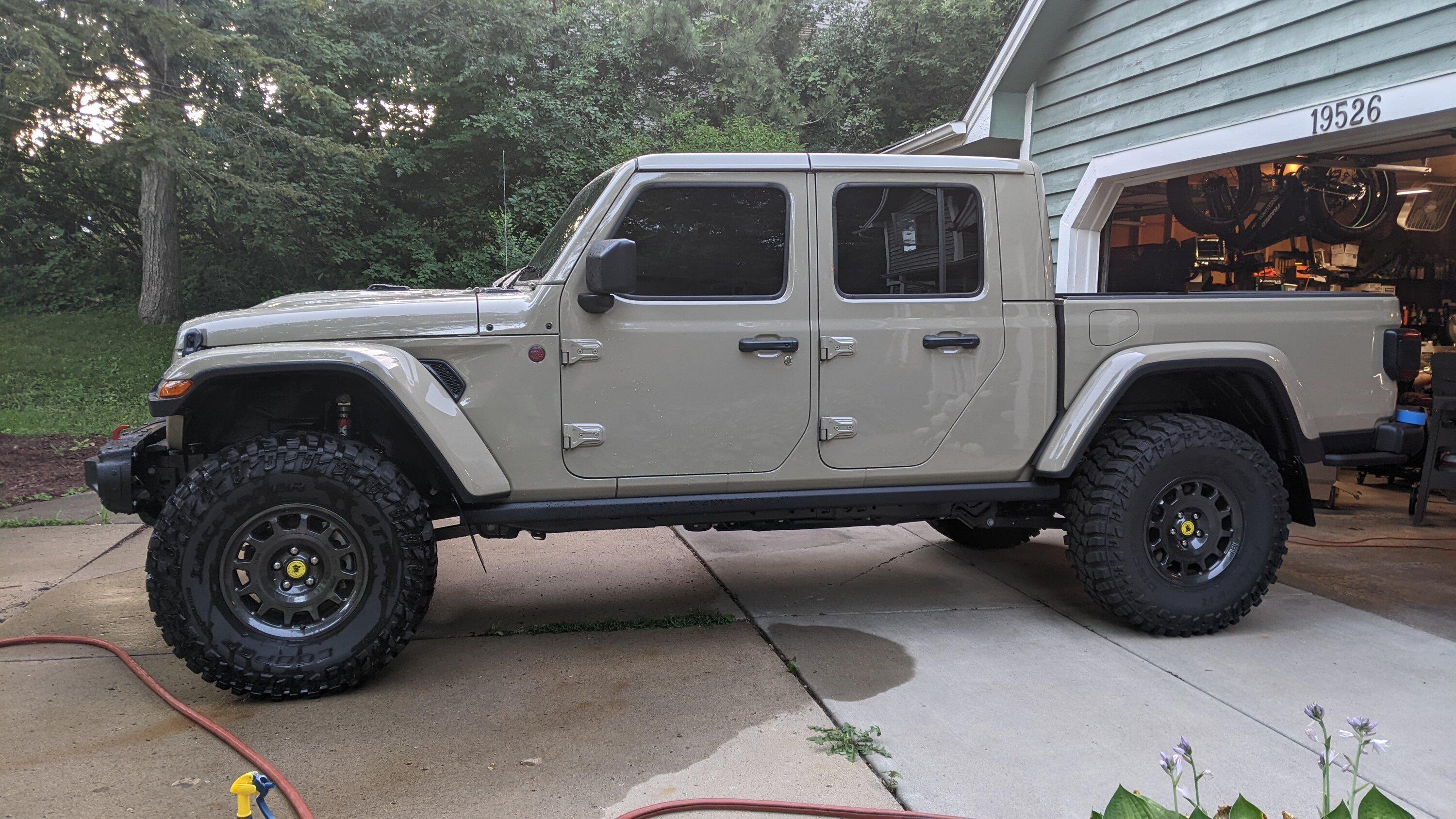

Pieced together spacer lift.
3" Front 2" Rear
Mopar lift front LCAs and front/rear sway links
RockJock bump stop spacers, carrier bearing spacer
Falcon jounces
Clayton front track bar
AEV Salta XR wheels 17x8.5 +25
37x12.5r17 Cooper STT Pro
Jeep Gladiator Lets see all those Gladiators with lifts and bigger tires! PXL_20220714_011816186

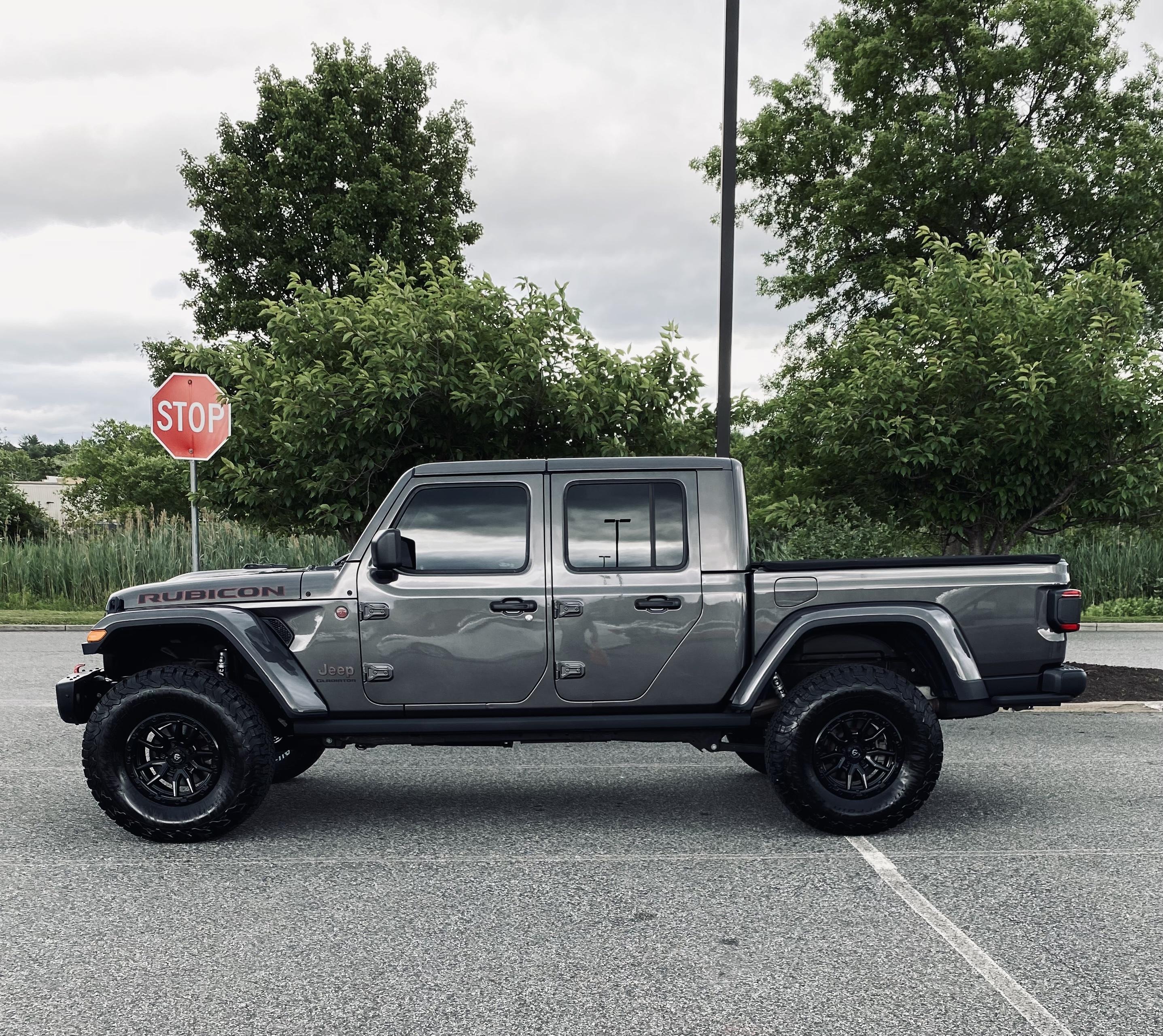

  • 2.5" AEV Dual Sport Lift
  • Steer Smarts Adj. Front Track Bar
  • 35" Falken Wildpeak AT3s
  • 17" Icon Rebound (-6mm offset / 4.5" Backspacing)
Jeep Gladiator Lets see all those Gladiators with lifts and bigger tires! AEV

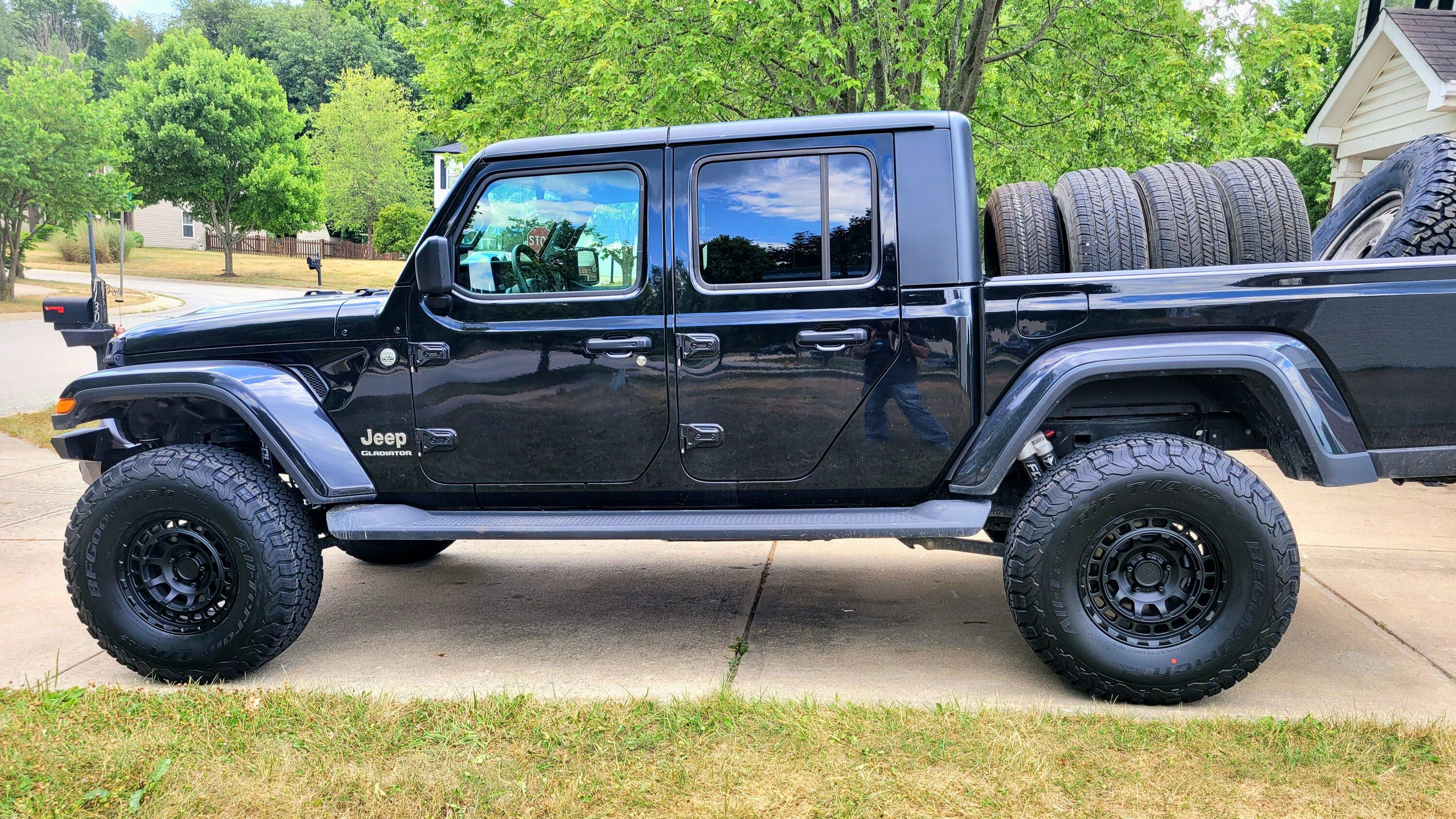

- offset pushes the wheel out giving you poke.... it's the back spacing that would determine if you need spacers. I have -18 and poke out about an inch, you can expect a lot more more with -44. Here is a pic with 4.04" backspacing and -18 offset.
Jeep Gladiator Lets see all those Gladiators with lifts and bigger tires! 20220704_184033
11,516
30,708
- offset pushes the wheel out giving you poke.... it's the back spacing that would determine if you need spacers. I have -18 and poke out about an inch, you can expect a lot more more with -44. Here is a pick with 4.5" back spacing and -18 offset.
That's a 9.5 wide rim?

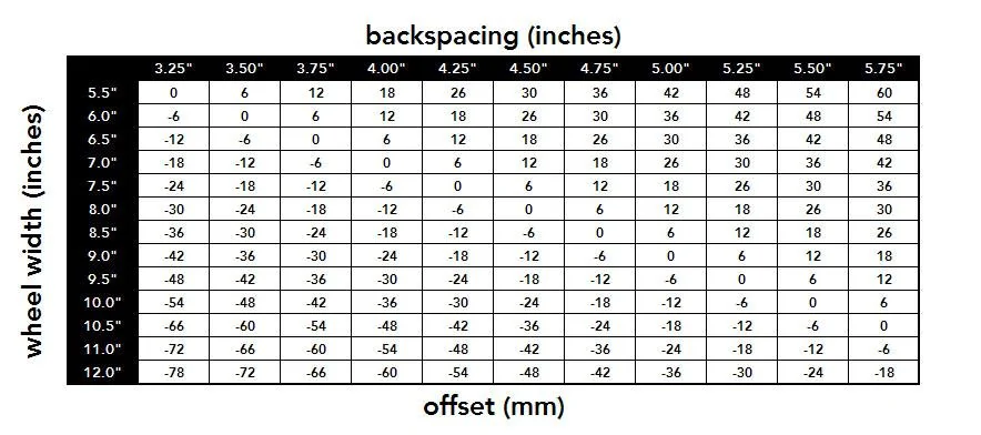

Does not compute. 8.5' wide, -18 offset, The BS would be 4". You would need an offset of -6 for a 4.5" BS.
On that topic, I found several wheels listed online when I was shopping for mine, where the math simply didn't compute. Seems copy/paste is particularly rampant in that industry.
Not that it applies here specifically, but when in doubt double check

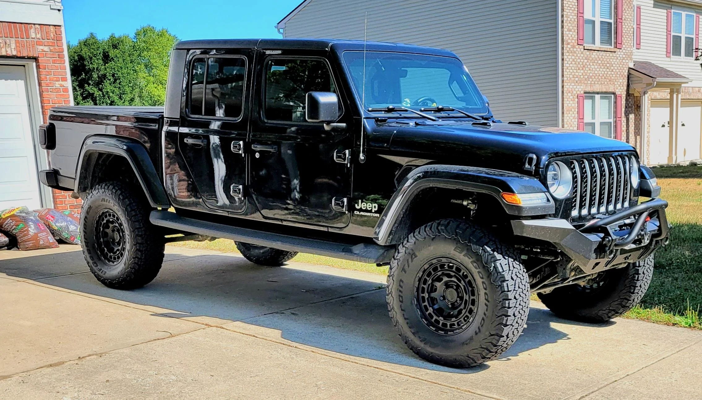

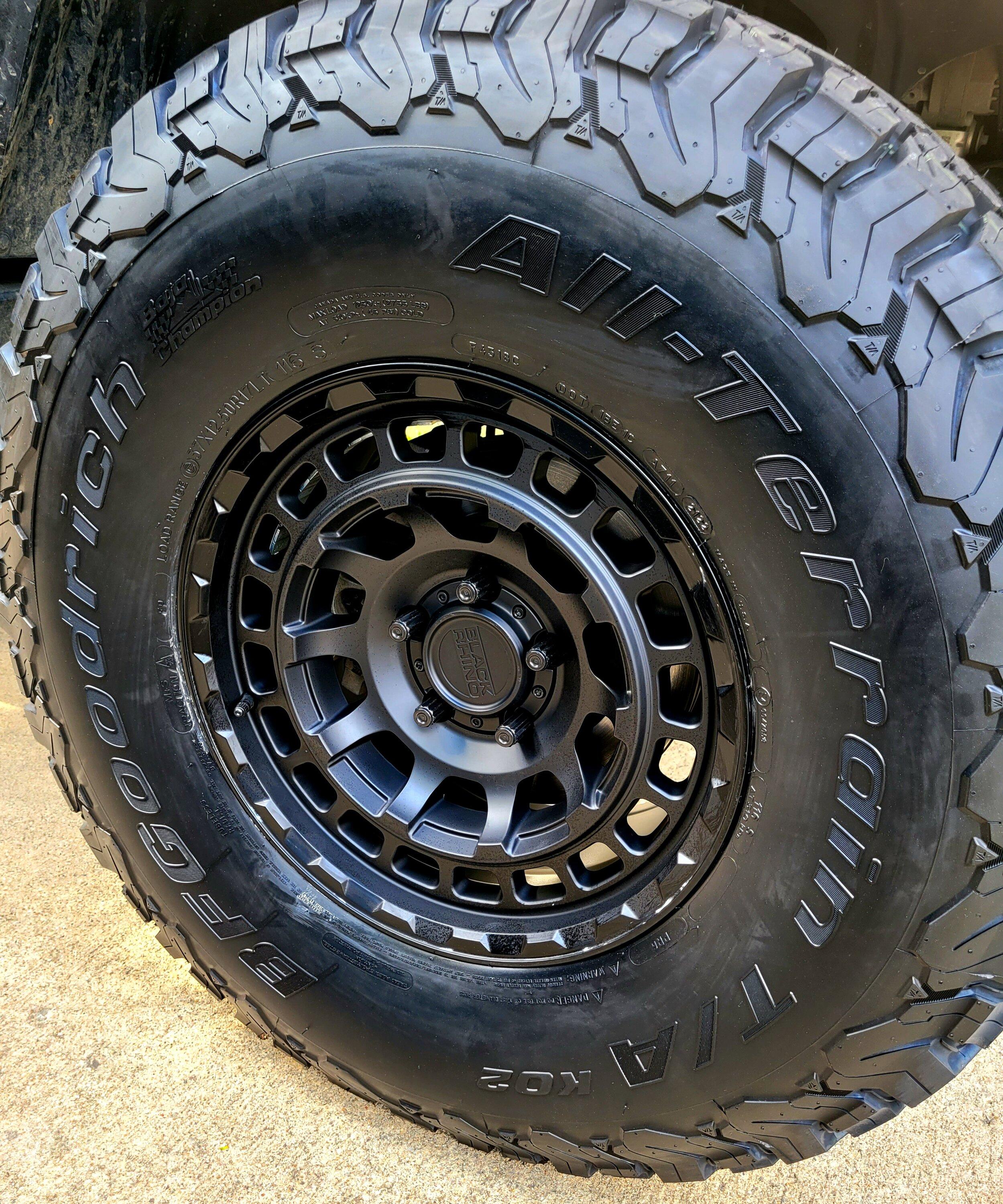

Here’s Black Rhino Armory 17x9.5 4.5 backspace -18 offset with 37x13.50 17 STT Pro.
Jeep Gladiator Lets see all those Gladiators with lifts and bigger tires! 08E03128-26F5-4D57-9AB3-04F613BDA73E
Here’s the same wheel with Falken Wildpeak AT3W 37x12.5x17. I’m waiting for my order of Black Rhino Arsenal 17x8 5.68bs +30mm offset as I don’t like the look of the AT poking out that far. I’ll post a similar picture when I get the tires swapped to the new wheels.
Jeep Gladiator Lets see all those Gladiators with lifts and bigger tires! BA757599-305D-4A32-84AD-D9CB69D811DC
