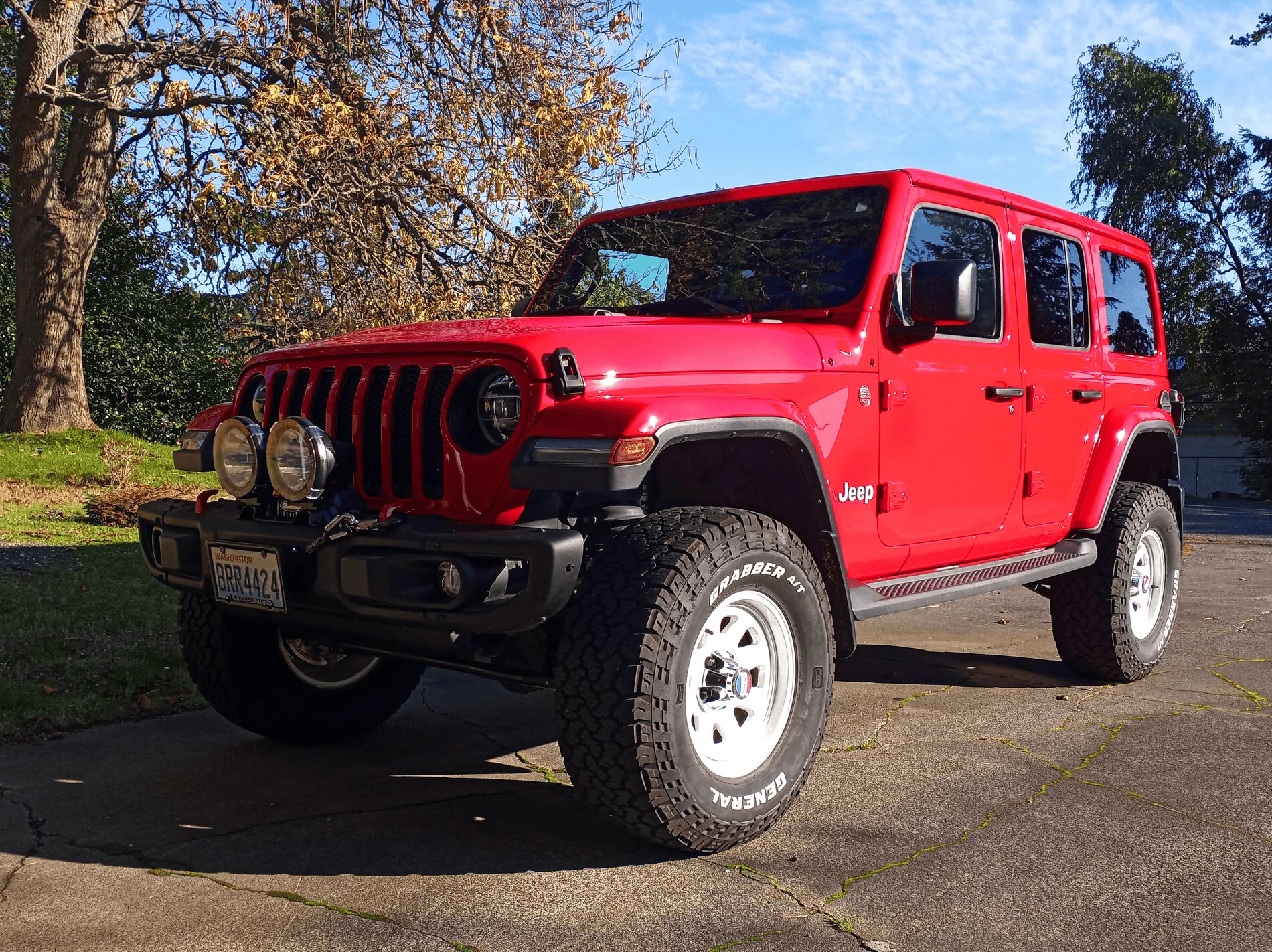

The Mopar lift gives the Jeep an awesome ride and lots of articulation, whereas I don’t particularly like the looks of the high fenders. They look dorky IMO.
Having said, adding a lift and 35s gets you into a never-ending rabbit hole.
In my particular case, I had to:
  1. Add an adjustable track bar
  2. Replace the OE steering damper with a Fox 2.0 stabilizer
  3. Find a dealer willing to do the steering box TSB...and have them do it
On 35s the Jeep is a BEAST on the trails, but the big, heavy tires dropped my MPG from 20 to 14, as the transmission rarely shifts into 7th and 8th gears any more. So I’m now looking into re-gearing, which I don’t really want to do.
I might just live with the atrocious MPG or, if it bothers me too much, I might downsize to 34s...whenever tires in that size become available once again.
