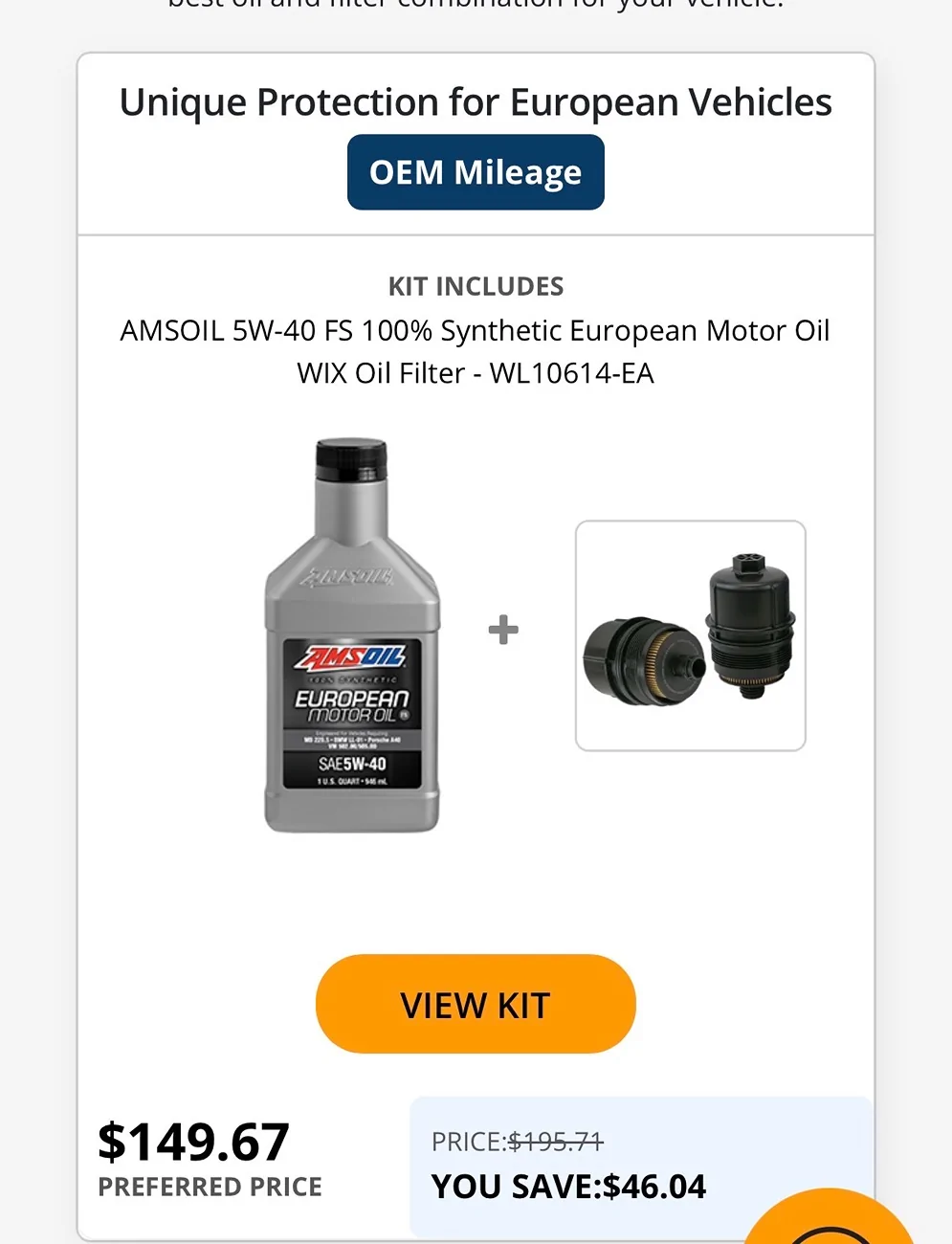

That’s about right.. 9 quarts at $16 a quart + the expensive filter costs about $150 iirc even if you DIY. That’s what amsoil shows me for their kit at least.
Jeep Gladiator Look at the prices for dealer oil change IMG_1611
