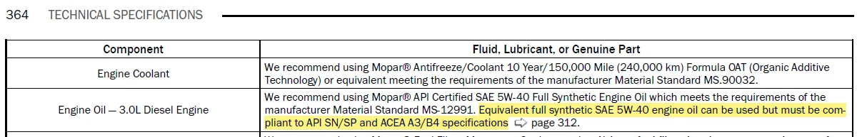

I'd guess the dealer did just that. If not, they're on the hook for the warranty. I wouldn't worry. 👍
I wouldn’t overly stress as it looks like it meets the other spec, and most modern engine oils are pretty damn good quality nowadays. I think the original frustration from the guy might have just been the principle of taking it in, paying a “factory certified technician” to use “OEM parts and lubricants”, paying the $300 for an oil change on the your ecodiesel to find out they don’t do any of that there.

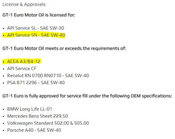

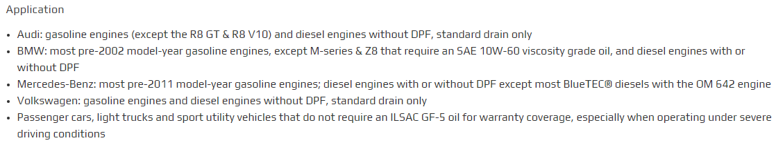

Damn I hate fine print. What about the don't use with DPF/DEF systems tho? It says low ash but then says No DPF use for most manufacturers
It only says don't use with DPF for Audi and VW.
Under passenger cars, light trucks, and SUVs, there isn't any restriction against using with DPF.
Thats what i eventually discovered. I wanted a definitive answer. Ended up at VM Motori looking over specs for the A630 (ecodeisel designation code) they confirm any SAE certified 5w-40 is adequate, and recommend Shell. Did you know the EcoDiesel also has a Marine application sibling? That was pretty cool, or at least i thought so.
