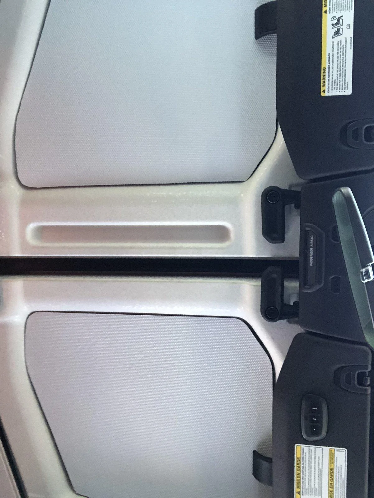

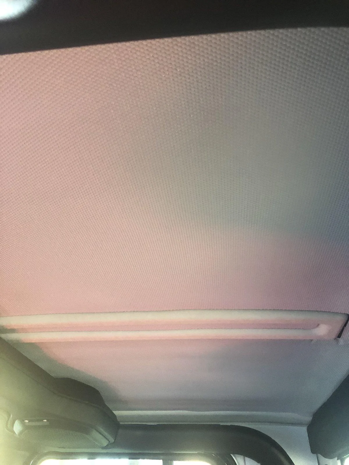

Boom mat $279 with a $30 gift card from quadratec. Made a big difference for noise and temp. Had to do a little trimming but turned out nice.
Jeep Gladiator Loud Hard Top 44229E48-CEA9-41F3-B943-43ABB86C608F
Jeep Gladiator Loud Hard Top 605A8298-A754-4731-9CC1-B1F9ADACA490
