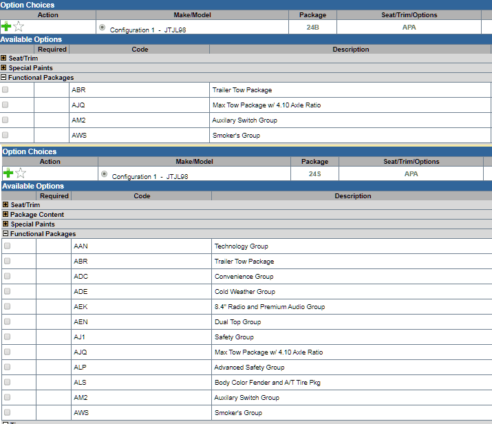

Your dealer should still be able to place the order for one currently though. The option would be gray and uncheckable or not shown at all if it was not available to be ordered.
They just tried it again at the dealer here in town. At the moment, they can only order max tow on the Sport and not the Sport S. When they add the 24s or whatever it is, it takes away the max tow.
When you go through the order process you start with the model so you would start by picking either 24B or 24S for the sport trim level. After that you go into the Configuration tab where you can add additional options like the Max Tow pkg onto it. The image i posted is the order process for a 24B or a 24S and Max Tow is available on both models at least where I live at.

Still not available on building a Sport S, using the Jeep website, as of this moment.
I just tried the build site and it works but only after you select the 8 speed automatic transmission which is down a screen or two. Then you can go back and select the max tow. The build tool should just automatically update the package selections like it does for some of the other options (like the dual top forcing a tonneau cover).
Yep, looks like it's back on there!
