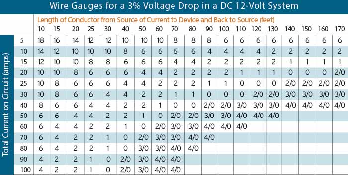

That's not how this works. That's not how this works at all. Think of voltage as a pipe of a certain size, and current as flow within that pipeline. The resistance will increase because the voltage (size of the pipe) will decrease with distance. The current will demand to remain the same as the load is demanding a set of amps, building pressure (resistance and heat). The lower voltage will not allow the amount of current to flow and the wiring will overheat because the pipe is too small. The fuse will not trip because it is current sensitive, not voltage sensitive. The practical reality is that if you don't increase wire size in accordance with the distance from the source to the load, you're not doing it right. And you risk burning up your wiring, your dash, and your truck. And with a degree in Electrical engineering and 32 years as a product safety specialist, I guess you could say that I am an expert.
I don't have a degree in electrical engineering - but have done automotive electrical repairs and restorations for decades........ and seen my share of things burned up by simple things like too much flow over a connector, which gets hot, oxidizes, causing more resistance, etc. - things melt.
I've seen people move their battery to the trunk and burn things up because they think they can use the same gauge wiring that the factory did - but increase the length 10 feet.
