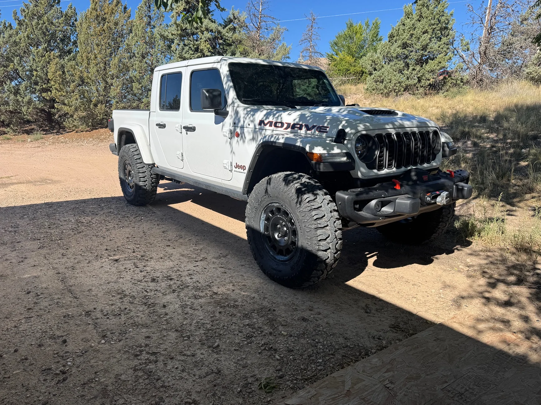

I installed the JKS Mojave specific lift with adjustable track bars. The only change I made was shaving down the aluminum bumpstop risers they include with the kit. They were simply too tall. 37’s, 5.38 gears, and some AEV wheels keep the tires tucked and not throwing crap at everyone else on the road.
Stay away from SkyCrapper. They don’t make good lift kits for ANY vehicle.
