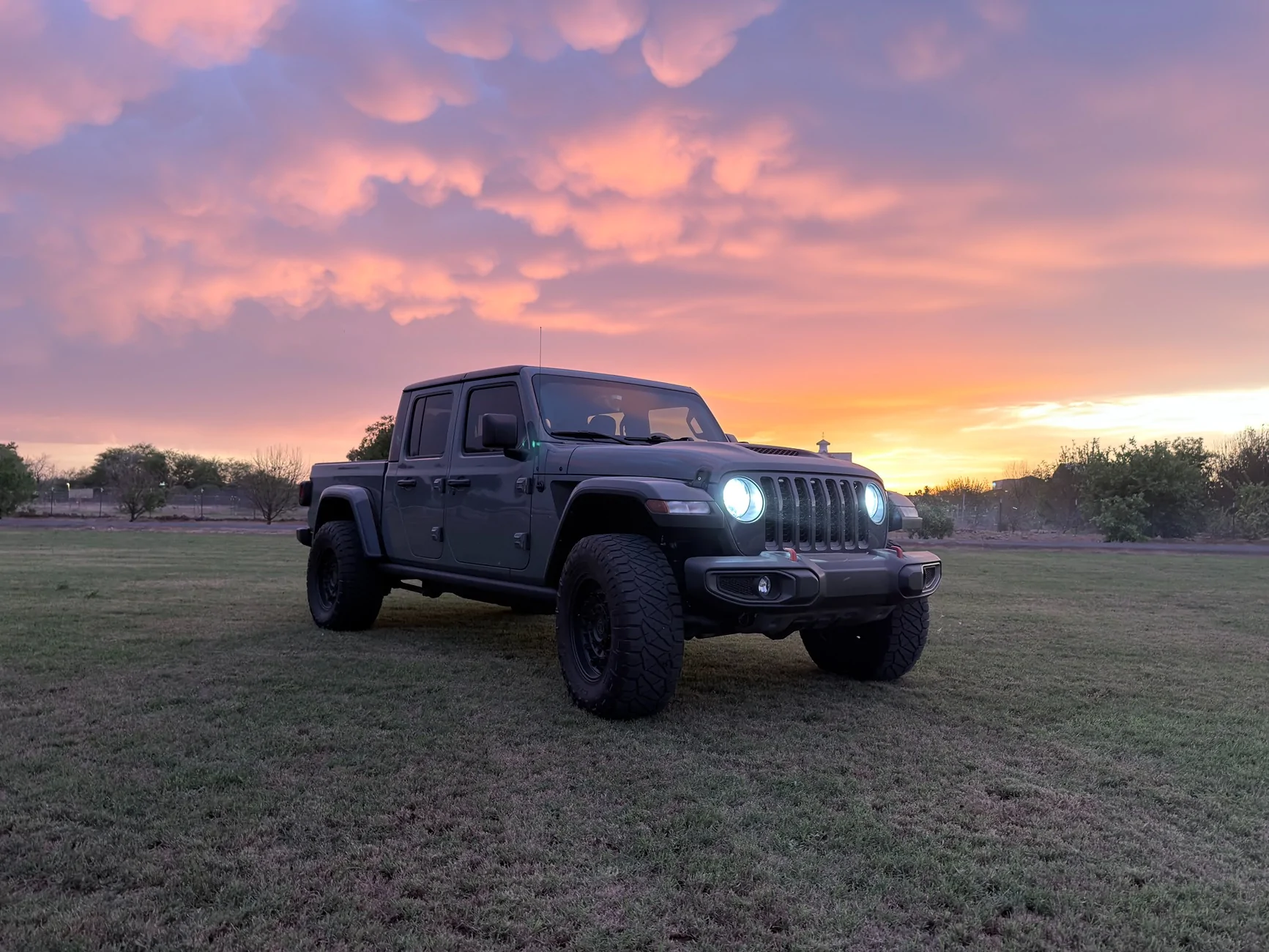

Rookie question for the group: I’ve never lifted a Jeep before. I’m currently running a stock height Mojave on 35s and love the setup, orignally wanted to avoid a lift, but I’m planning to install the SDI E-Clik system (Dive in on the deep end, I know). After talking to SDI, they mentioned the system is essentially knee-capped without a lift to allow for proper travel.
I initially looked at the AEV 2-inch spacer lift, but putting spacers on a performance-oriented E-Clik build feels a bit counterintuitive. I found a Skyjacker kit that offers springs and sway bar links (I’d toss their shock extensions since I’ll have the SDI E-Clik shocks).
For roughly the same price, would the Skyjacker springs provide better travel than the AEV spacers? I’m not very familiar with Skyjacker’s reputation. Does anyone have experience with their spring quality or ride feel?
