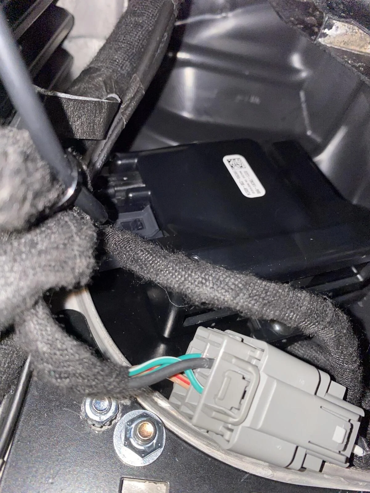

Just installed mine....I lack the words to describe just how much of a pain in the ass the controller box was to install. Probably my fault, as the dead pedal mount I have blocked the lower hole. I thought about just zip tying the box up somewhere but decided "naw lets try to get it in the right way!". NEVER AGAIN lol.
Jeep Gladiator Mopar factory trailer brake controller - my impressions and review ONHW3Ls
I have the MORE dead pedal, guessing you do to, snd yes… I said screw it snd zip tied mine.
