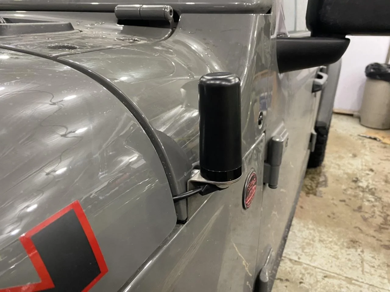

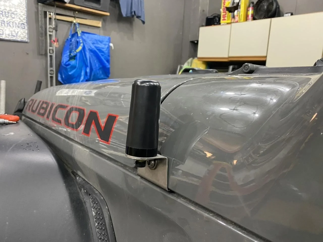

I got the 3db Midland Ghost antenna mounted to a cowl mount from CoolTech LLC
I've been looking for just this mount. Did you order just the bracket and mount from CoolTech or did you need the bracket, NMO adapter, and coax cable? Thanks!
I ordered it all from CoolTech. They are 2 separate items (Antenna, Bracket with NMO and Coax). If you order the mount from cooltech, it has drop down for their kit which is a little custom to include longer leads than the standard 6', with removeable end to make threading the interior antenna connector through passages easier, and the washers/spacers for the NMO antenna.

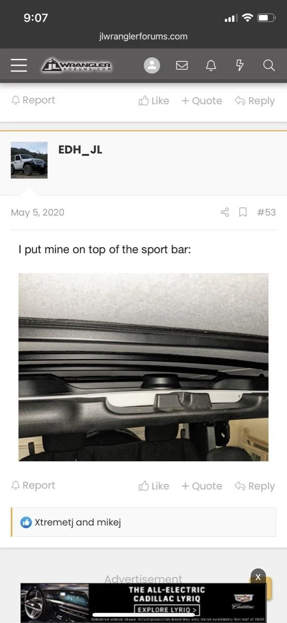

Surprised no one mentioned this. Seems like a slick option, though I believe you have to move the XM antenna (Maximus makes a relocation bracket).
