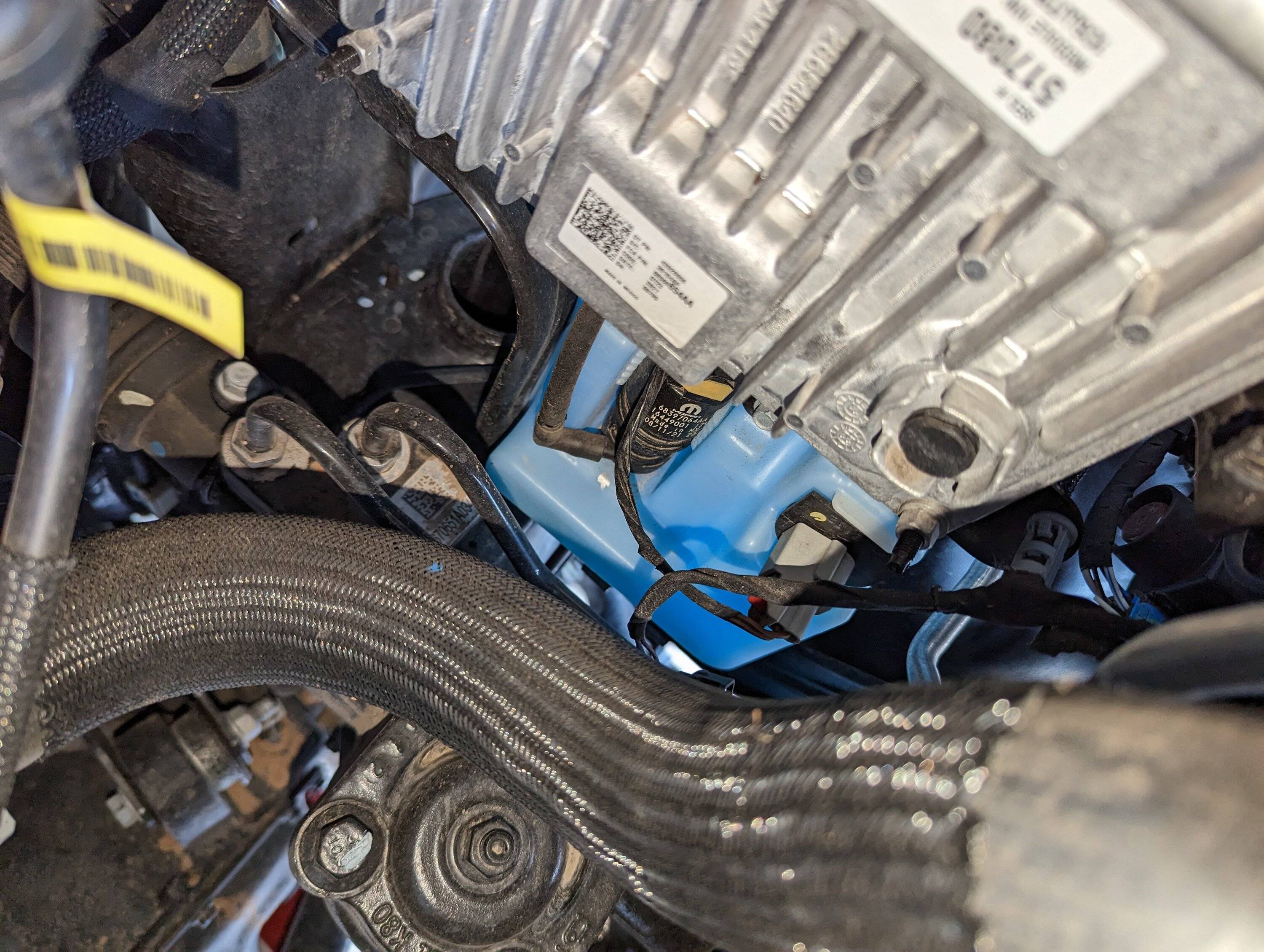

Pull the air intake tube off the throttle body and filter box and rotate it out of the way on top of the computer. You can get at the pump then.
This part was a pain. The hose will only route one way and you'll find square holes on the radiator support where the hose clips push into. There is a rubber 'protector' sleeve on one of the hoses that lines up where it could get smashed as it passes downward.... the muddy hose in this pic.
That does give better access, but oh my! Does the pump on the parts list replace the existing washer pump and hook up the same way (electrical connection and fluid hose, with exception of adding the camera washer hose)?
I'm taking videos as I go, to hopefully save you questions in the future...
Thanks again!

I actually just did this. Other than removing the ECU there is no otherway to get better access. The good news is pretty easy to disconnect the hoses. You don't need to unplug the wiring harness from the pump because the harness gets replaced. Will need to remove one of the bolts that secures the ECU to remove the old harness. Then unplug it by the fender.
For running the hose to the camera there is a plastic panel on the drivers side of the grille held in by two push pins. Remove that and it's a straight shot to the pump.
Thanks again!
Thanks @ecidiego I got it installed. The hose that connects to the pump could stand to be 3-4" longer, but I got it to work. This was easier (with your guidance) than the back panel behind the seat!
I've got some videos from my process that might help others that I'll get together over the next couple of days...
Thanks again!
Thanks again!
You ran it diagonally across the grill right? It clips in on its way to the camera.
