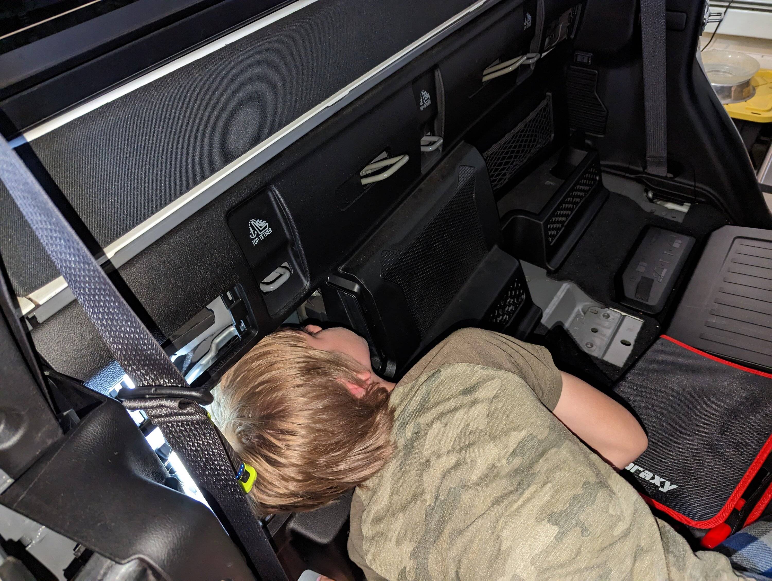

The back rear panel is seriously a PIA! I highly recommend thinking about how much money your own time is worth, potentially buying a replacement one, and ripping the stupid thing off. I only broke two or three clips and one might be able to be super glued back on. A small headed and handed helper is highly recommend also!
Jeep Gladiator My OEM Front Trail Cam install thread PXL_20230610_182152585
