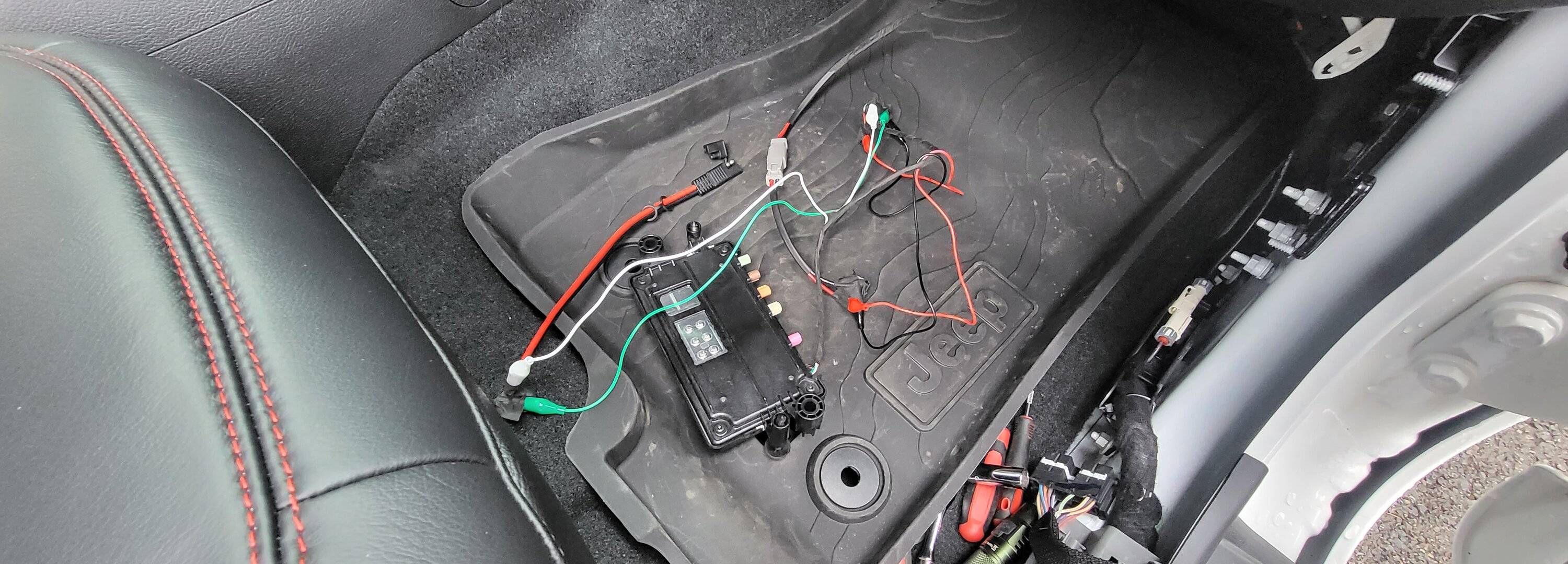

I guess the real challenge is the CVPM and the AlphaOBD compatibility for MY 2023.
The plan is to hook up everything on the passenger side with gator clips and test leads then change the BCM parameters and verify function before taking anything apart. Hope that won't take too long.

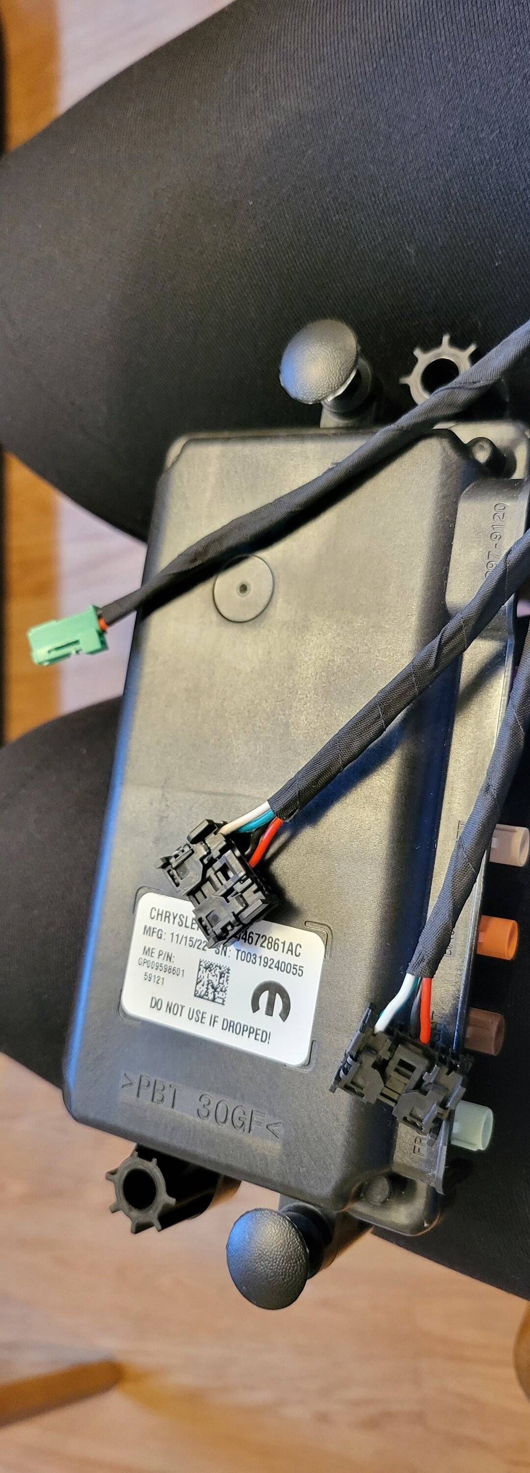

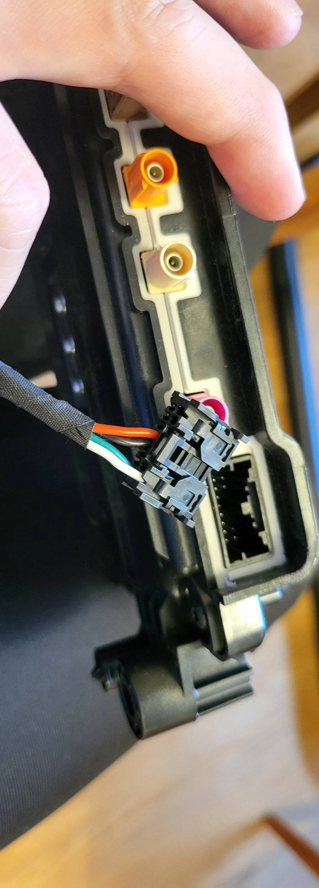

Jeep Gladiator My OEM Front Trail Cam install thread 20231230_104517
Jeep Gladiator My OEM Front Trail Cam install thread 20231230_104543
Making a few harnesses. Found 26 ga wires do well with these connectors.

Jeep Gladiator My OEM Front Trail Cam install thread 20231230_124658
CVPM wired in. Cameras next.

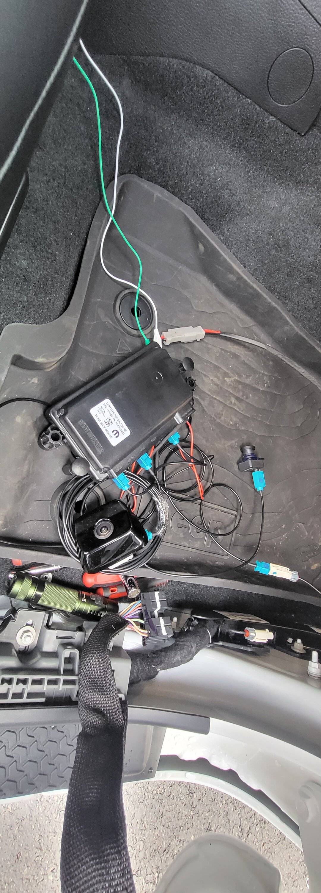

Jeep Gladiator My OEM Front Trail Cam install thread 20231230_143321
All wired in and all parameters set via AlfaOBD Android version.
Did not get the washer part started yet.
So far so good as I was able to follow through all the instructions.
How long have yall waited before all the functions started working?
