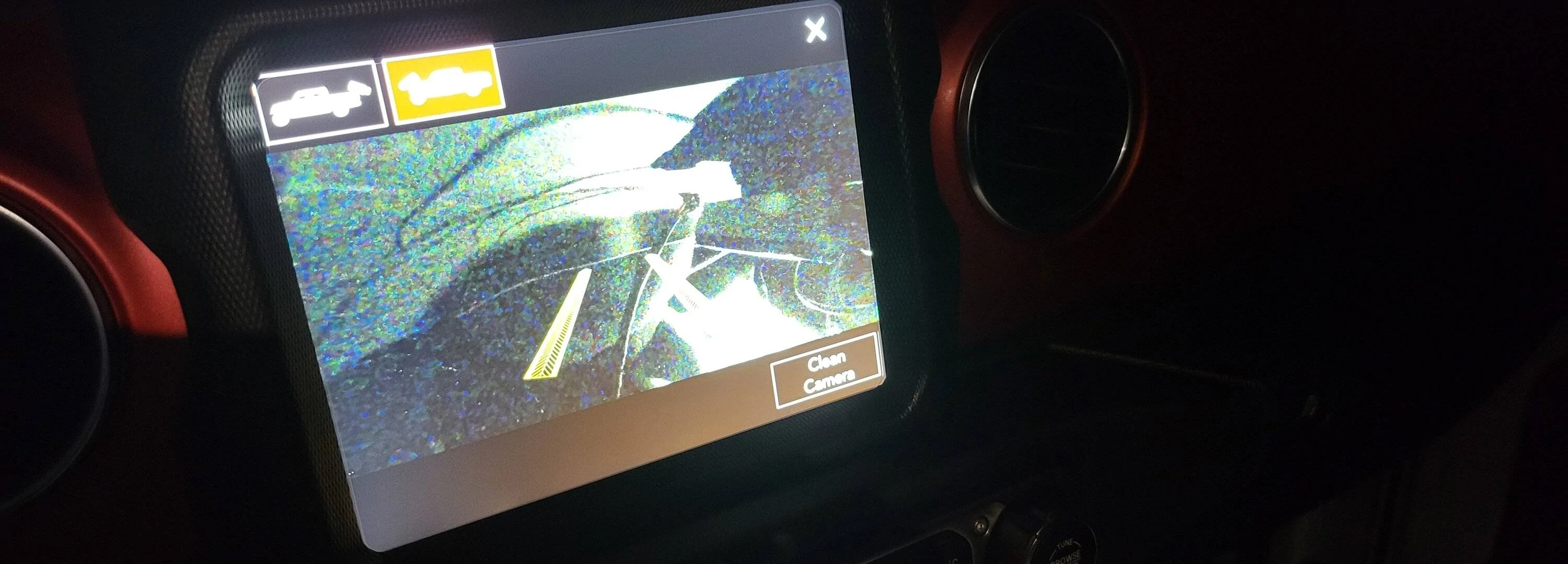

Front cam works!
It has been roughly 6 hours since the install. I am curious as to what is happening with the machine and how the configuration is updated. It takes so looong.
Interestingly, offroad page disappeared and I believe it is likely due to how the system is upgrading? Or at least that is my hope.
So 2023 AlfaOBD works, CVPM works at least for the cams. Will update with a few things that caught me off guard and I still need to figure out the washer motor/cable/plumbing routing. Will document the rest of the process.
Update: I am sure all the posts I made have some time stamps. This gave me a rough idea how long the configuration propagated through the Jeep. I kinda started after lunch time and it is now almost 10. I confirmed all the camera functions work as well as the menu. About 8 hours or so, the install and configuration is complete.

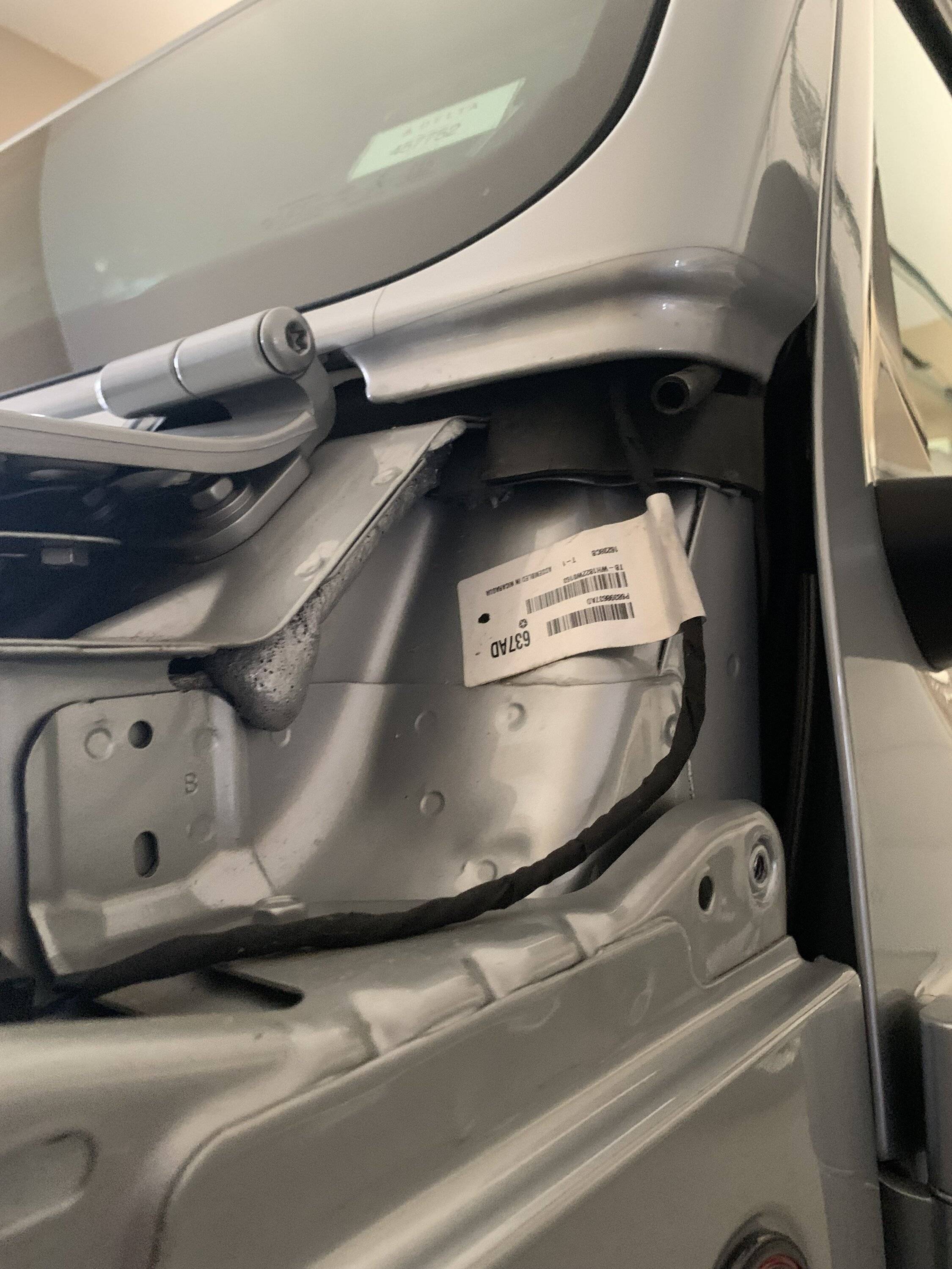

also, I may not run my 2 wires (power and farka) through the firewall. was looking at the drivers side and there is a small set of wires entering the the cabin through what appears to be the windshield gap:
Jeep Gladiator My OEM Front Trail Cam install thread IMG_6250
I
I am leaning towards following this method on the passenger side of the vehicle.

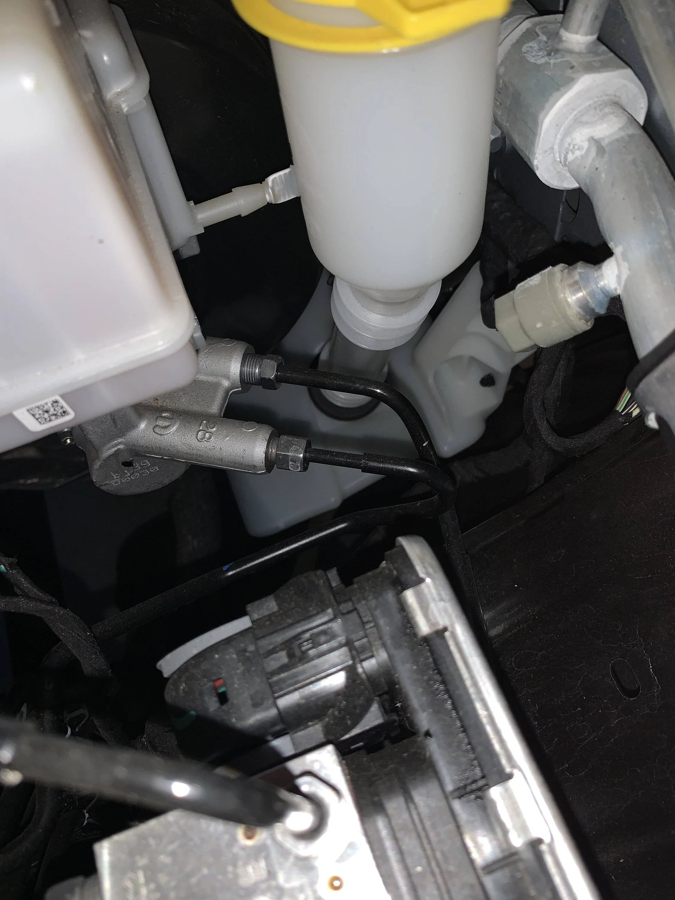

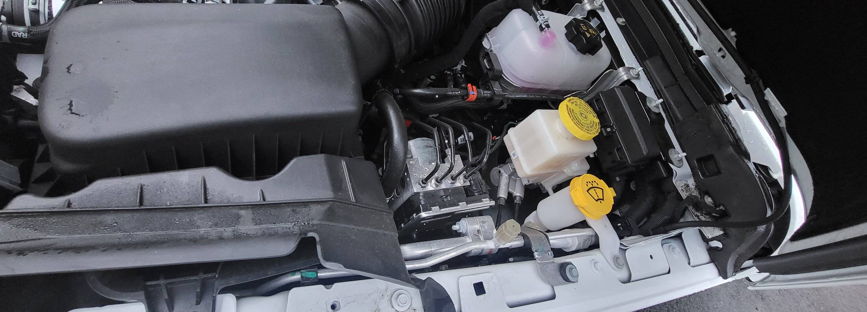

now, if only I could figure out the washer system…that appears to be an enormous challenge which I have no solution for. I can’t even see where the pump goes into the tank or even how to move the tank enough to explore.

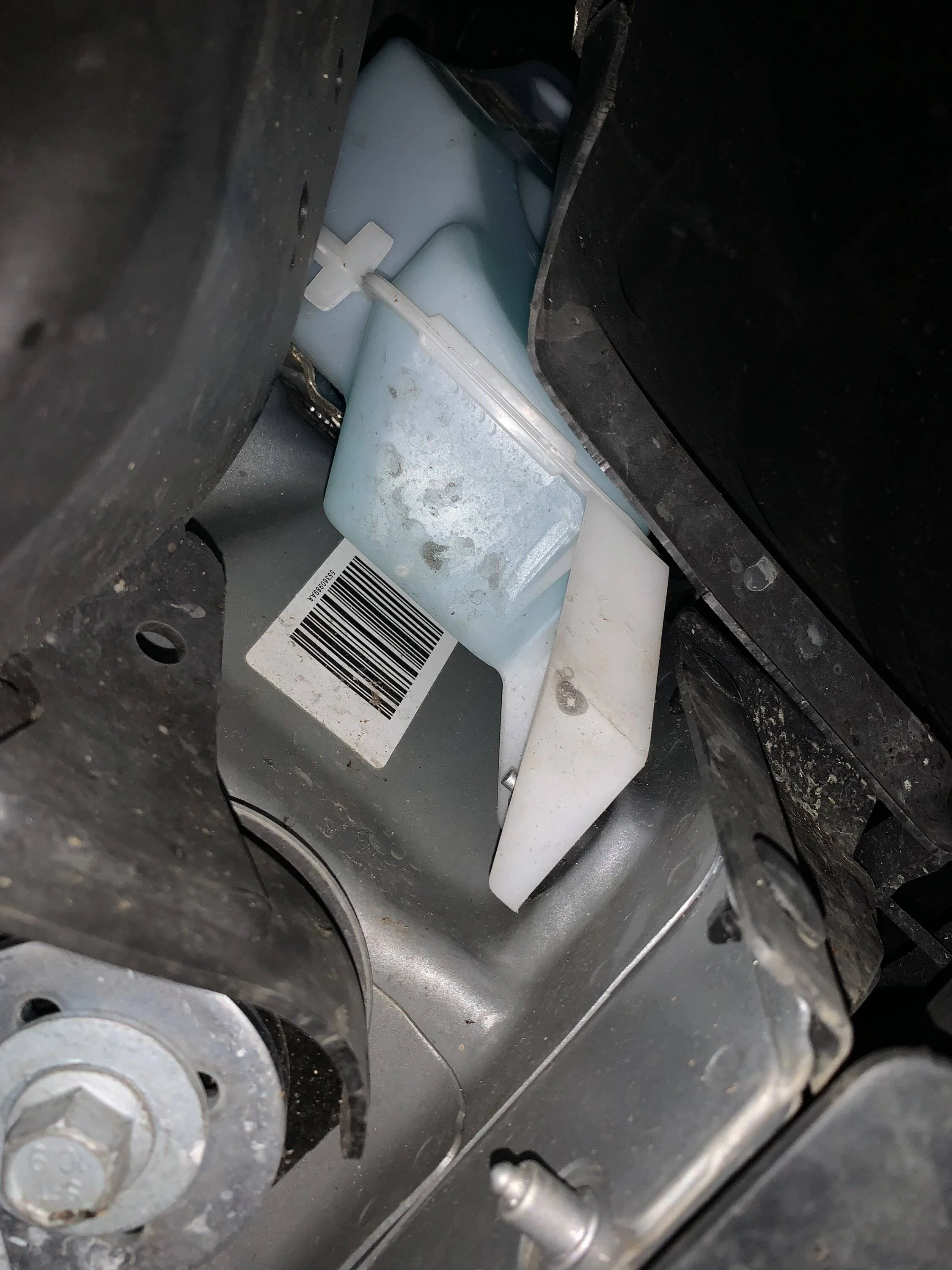

That washer tank looks like a dumpster fire to remove…mine is definitely on the drivers side but I’m sure is “relatively” similar. How many bolts do you count that I will have to remove on the gas version to get that out? It does appear I’ll have to remove the wheel liner.
from the the bottom:
Jeep Gladiator My OEM Front Trail Cam install thread IMG_6251
From the bottom:
Jeep Gladiator My OEM Front Trail Cam install thread IMG_6252

I was wondering why the washer hose instructions made no sense on my diesel. LOL. The hose from pump to front hose listed is about 1~2 feet short.
Access would not be too bad once the liner comes out.
Not sure of the electrical harness is long enough... We will see.
I do have a fix on the way for the washer hose and will update once it is done.
