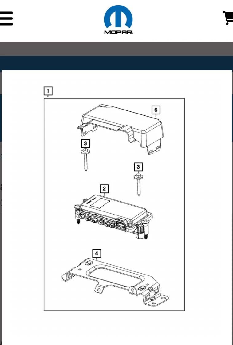

Okay MOPAR parts gurus, I need some help find a few parts for this install under the seat. When doing a random search I found the below pic for a 2022 Ram (Camera Processor Module - Mopar (56029965AC). What I need is the parts number for #4 and #6 and to a less extent #3. If I can get those parts I think the install under the seat will be a cinch and repeatable for those that follow.

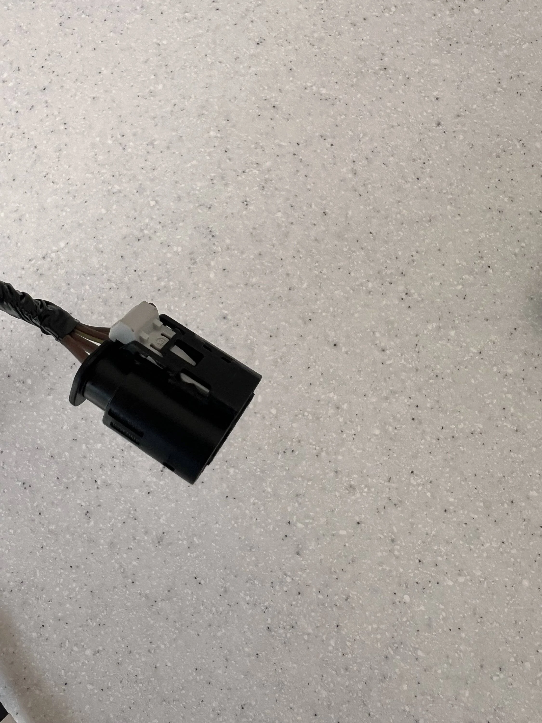

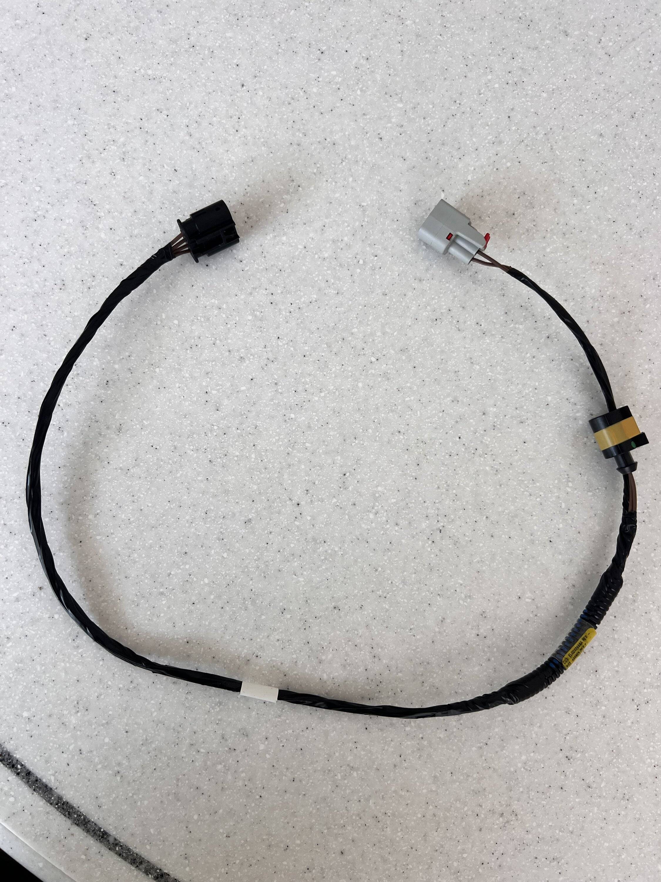

Can anyone tell me where the jumper harness for the washer pump plugs into at the other end?
I’m having trouble tracing the existing harness from the pump back
Thanks!

Yeah that would be even better to find out where in the wrangler but using my logic and reason (which often doesn’t apply to Chrysler) ours was on the back wall there’s must be in the trunk area of the wrangler.
@ecidiego, I’m utterly amazed how quickly you located those parts! That had used up 2 hours today. If it works, That bracket will help me not reinvent the wheel to create one for a weird design on that module. BAM didn’t have those parts so I couldn’t use them…seems kind of often these days.

So the hose will reach, which is great, however I can’t for the life of me locate the harness plug for the pump wiring.
It’s driving me a bit crazy
Also, is it the white pump outlet that feeds the camera nozzle?

The pump only goes in 1 way, it will be clear as day which nozzle is which.
Ok, mines very different.
The wiring is taped into the main loom just after the motor plug.
Does swapping the two pins in the pump connector on the current loom do the same thing?
