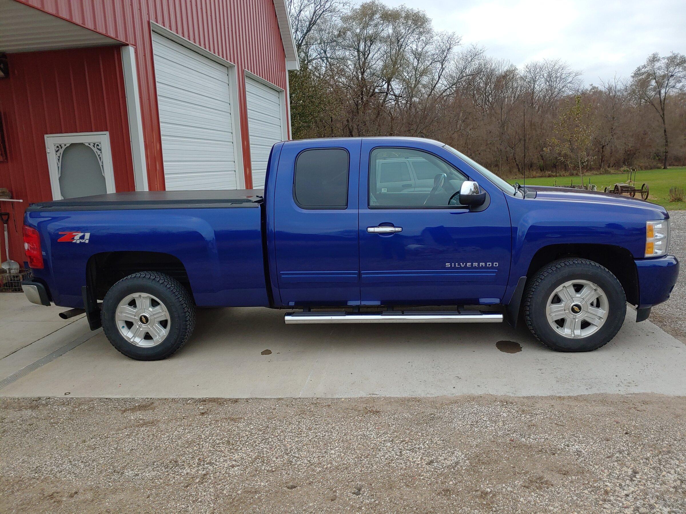

This was one of my last cars ...........
Jeep Gladiator New Engine Needed at 42k miles!?!?! 20191105_145256
I defer to you in all things automotive, you are truly a wealth of information and I would never dare to question you.........but, ummm, that’s a truck ?
:(:( Well, that explains the truck plates they insisted I have.
