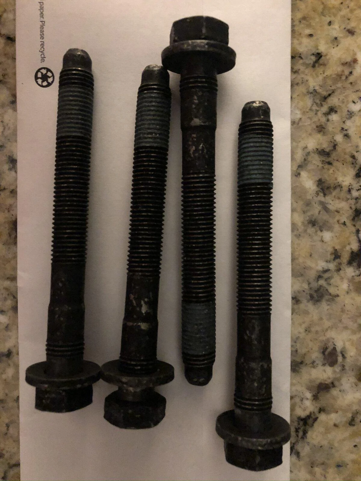

Picked up the new frame bolts at my dealer today. I have to admit these are way larger than I expected. I haven’t really looked at how the steering gear bolts on but I wasn’t expecting this. $12 each.
Through the frame rail, and thread directly into the steering gear housing. The bit on the end helps start them straight into the threaded hole in the steering gear during factory assembly - a guide, of sorts, to keep them straight and prevent cross-threading.
Looks like they have thread locker.
