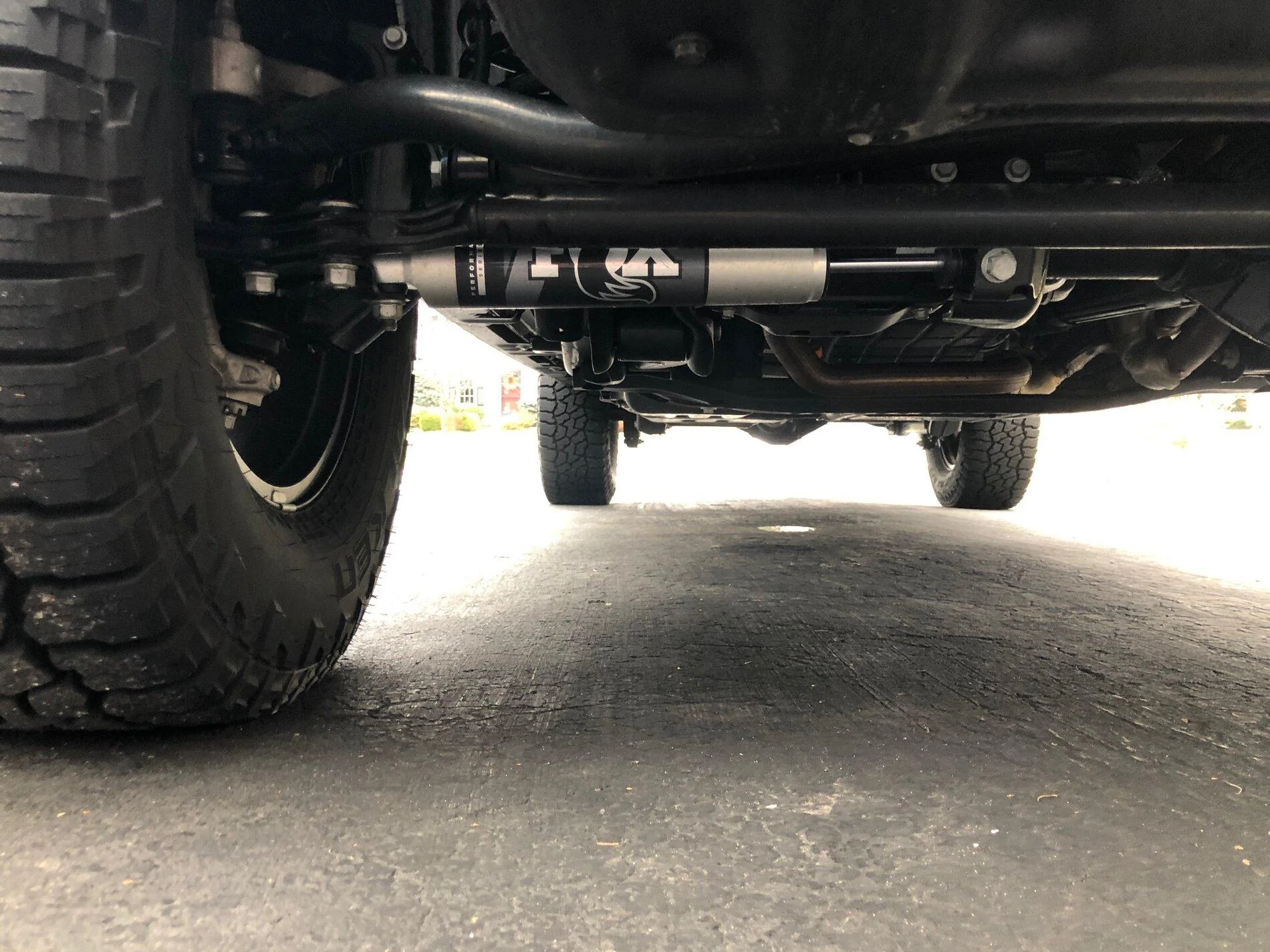

I originally took my glad to my local dealership to have it looked at in mid October. After confirmation of the issue, I was told that the parts would arrive within about 2 weeks. They ended up having to place my vehicle in "VOR or Vehicle Off Road" status before being told that the parts would not arrive until Mid December. Once the parts were in, it took them about 2-3 hours to complete the install and had it back before noon. Tremendous difference especially with bumps and at high speeds.
I had also purchased the FOX "Performance Series 2.0 Smooth Body IFP Steering Stabilizer" before having the issue fixed, and with that combined with the new parts, its like driving a completely different vehicle. Highly recommend!

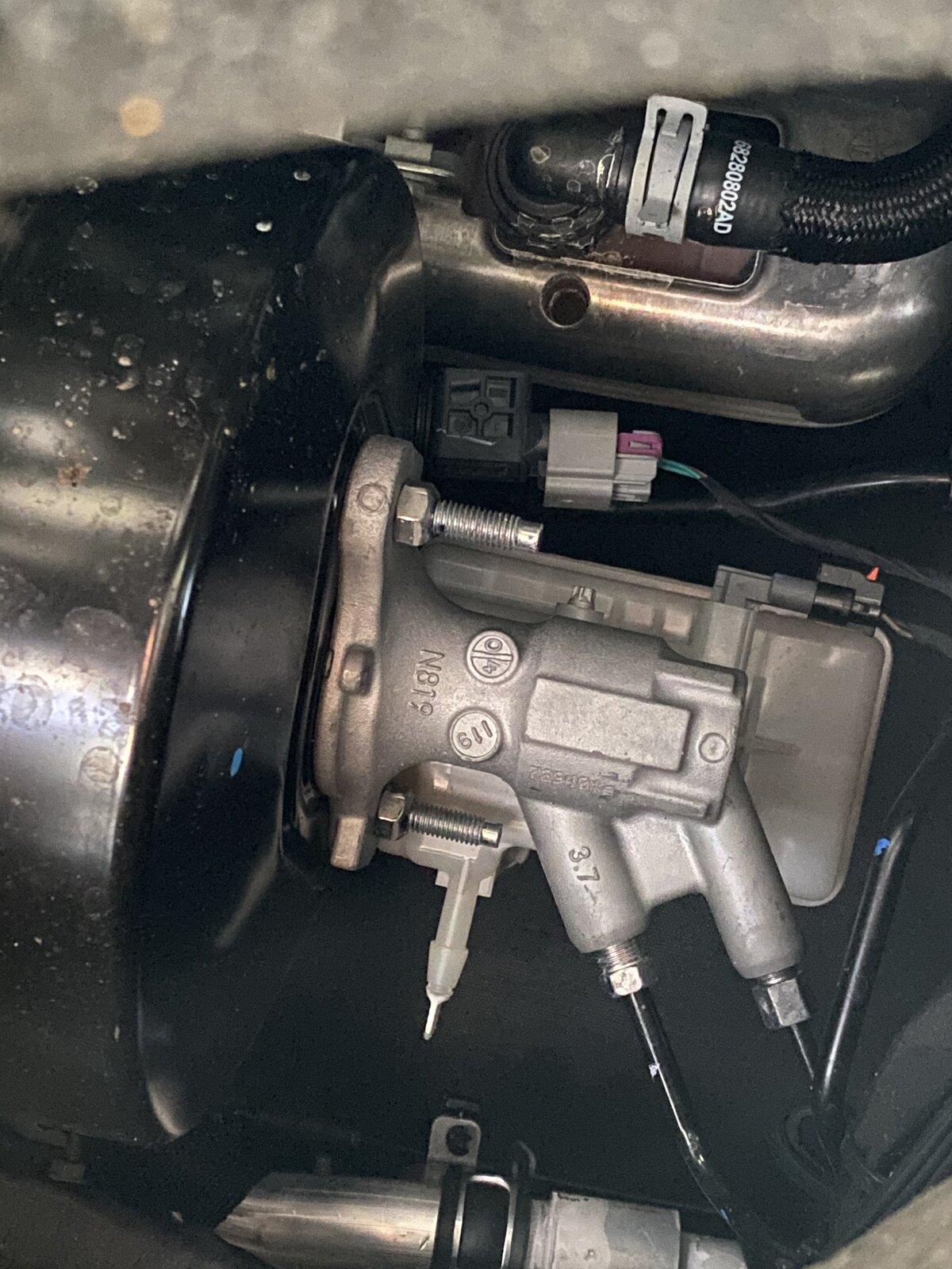

So at freeway speeds, 98% of the play when tracking straight is now gone (YMMV). Can’t say I had huge problems like others experience (maybe an 1”, 1.5” of play at center noticeable more at freeway speeds).
I had the TSB done on Tuesday. I took a picture from behind the splash guard. I didn’t see anything quite like this.
Is there a different angle I should shoot from?

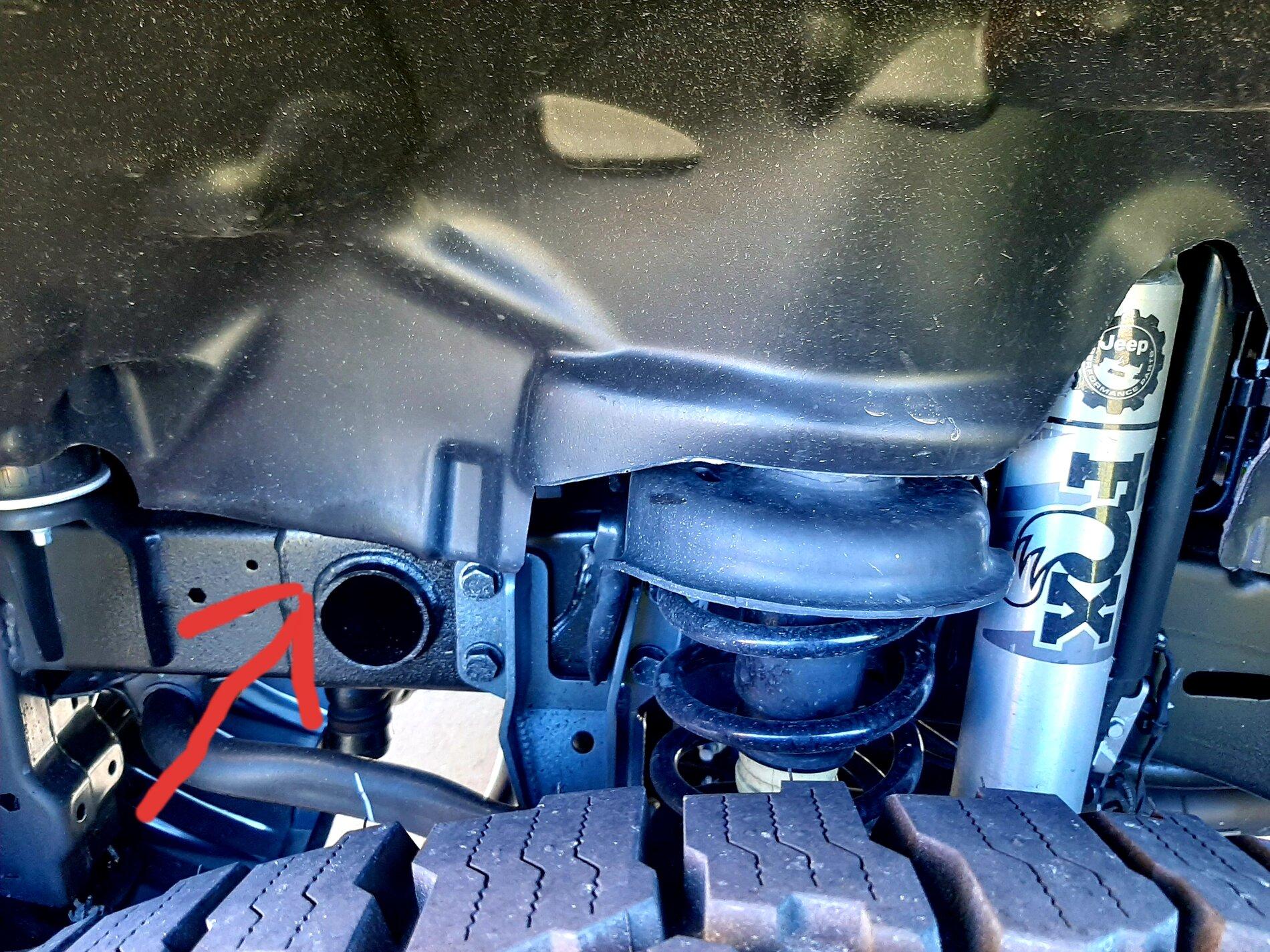

Behind the driver side tire lift up the plastic sheild near the coil spring. It's just ahead of it.
Looks like you have the brace on yours.
