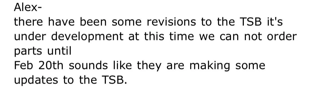

My TSB appointment was all set for tomorrow and I got this email today. The service is disappointing and the quality of the truck is as well in regards to the steering. Since driving the car off the lot 3 months ago I’ve had to take the truck to the dealership service department two times. After getting the note today I have to wait even longer to have a perfectly operable vehicle. This is a lot of headache for spending 50-60k. I work in building world class brands and the core relationships with our community of enthusiasts. I hope jeep can regain my trust and that of the community who have this steering issue. I’ve been in their shoes before. But as a customer my patience is becoming a burden.

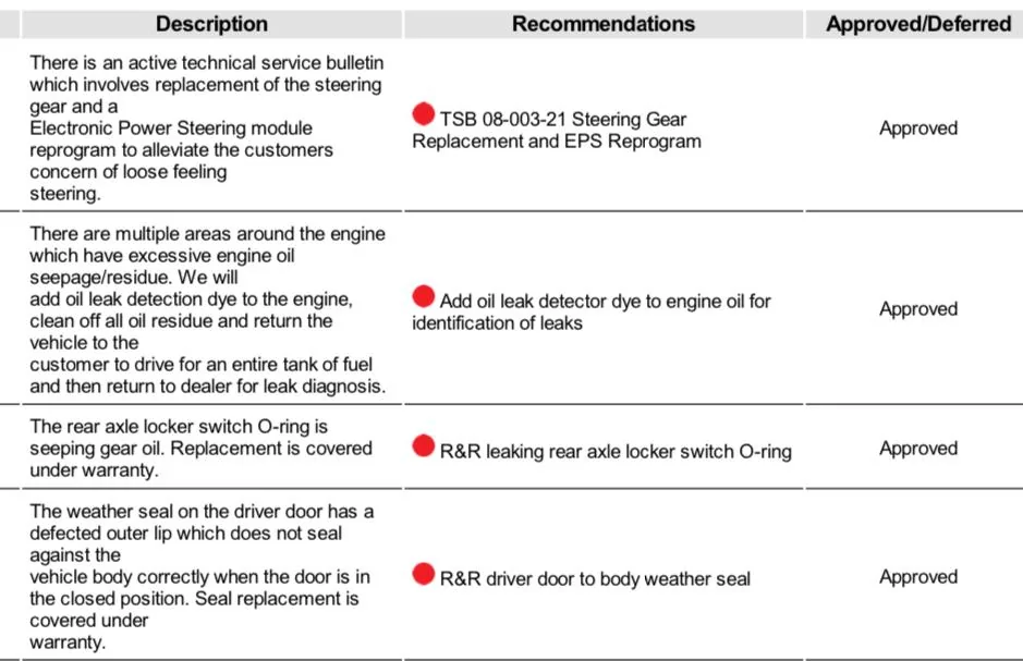

Had they already inspected yours and approved the replacement? I took mine in yesterday and received notice today that mine was approved.
