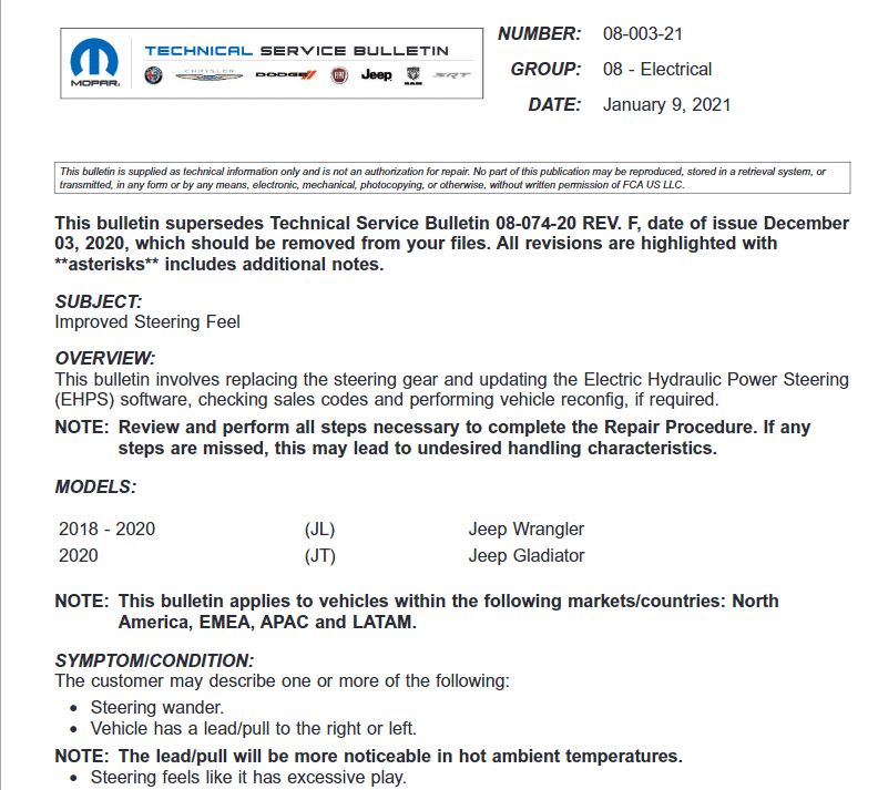

@ShadowsPapa - The TSB has been updated to now include an alignment. It has been replaced with a new TSB number. Please see top portion of the TSB below. The only change to the TSB is to give the vehicle an alignment after replacing the parts.
Jeep Gladiator New JT Gladiator Steering Issue TSB 08-074-20 (for "Improved Steering Feel") 1610589957099
Please let us know if you have any questions.

THANK YOU - can I take mine back and have that done since mine wasn't centered after the original TSB and it's tending to wander again.

Got the call mine is in while the truck is already in the shop, which is nice. I was going to get an alignment anyways after the lift install, but now it should be covered right? Service tech did mention that if they have to adjust the camber, it isn't covered for the TSB.
Yes, we recommend returning to your dealer.
Yes, the alignment is covered because it is included in the TSB.
