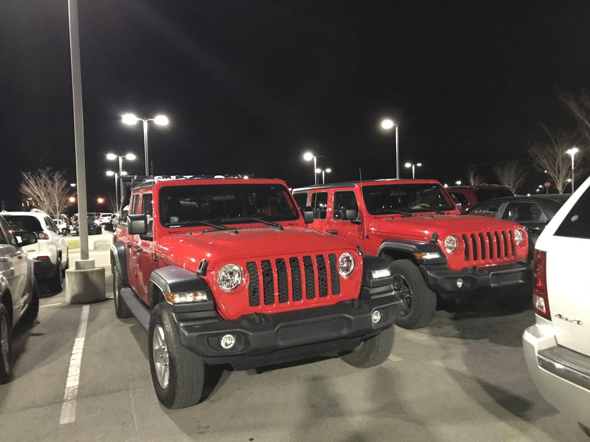

Iā€™m at 26,000 miles and decided to get it done. It does wander and with wind can be a handful but every open top Jeep Iā€™ve owned has always done this. I am taking your word on this here so the Gladiator is dropped off to get the new steering box and reprogram in the am. Parts took 3 weeks to get. I canā€™t wait to see the difference.
My JT even has a friend to spend the night with.

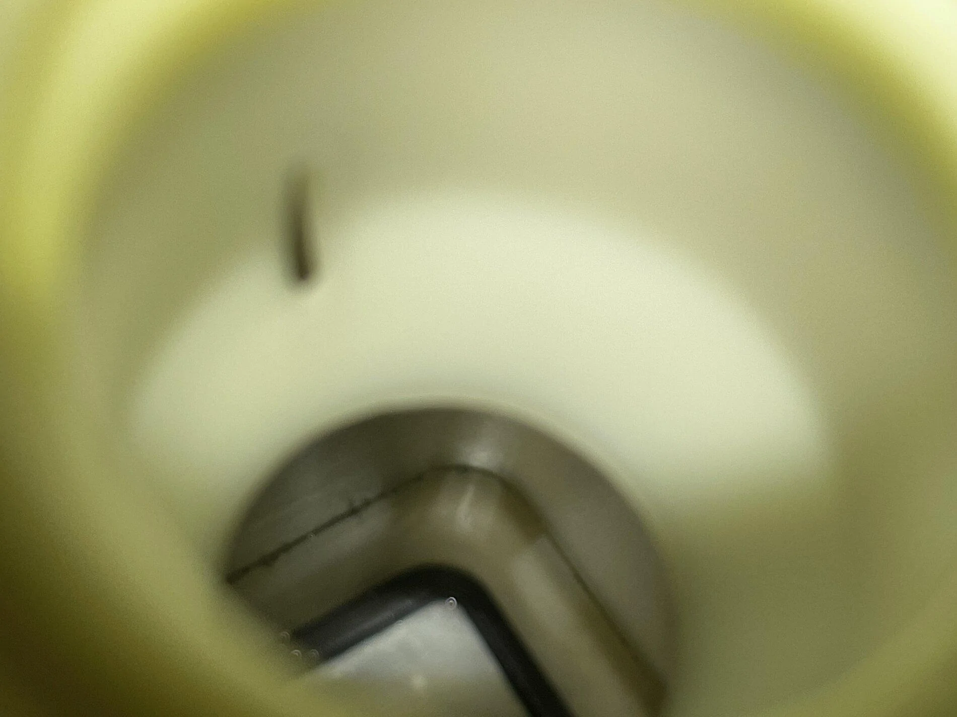

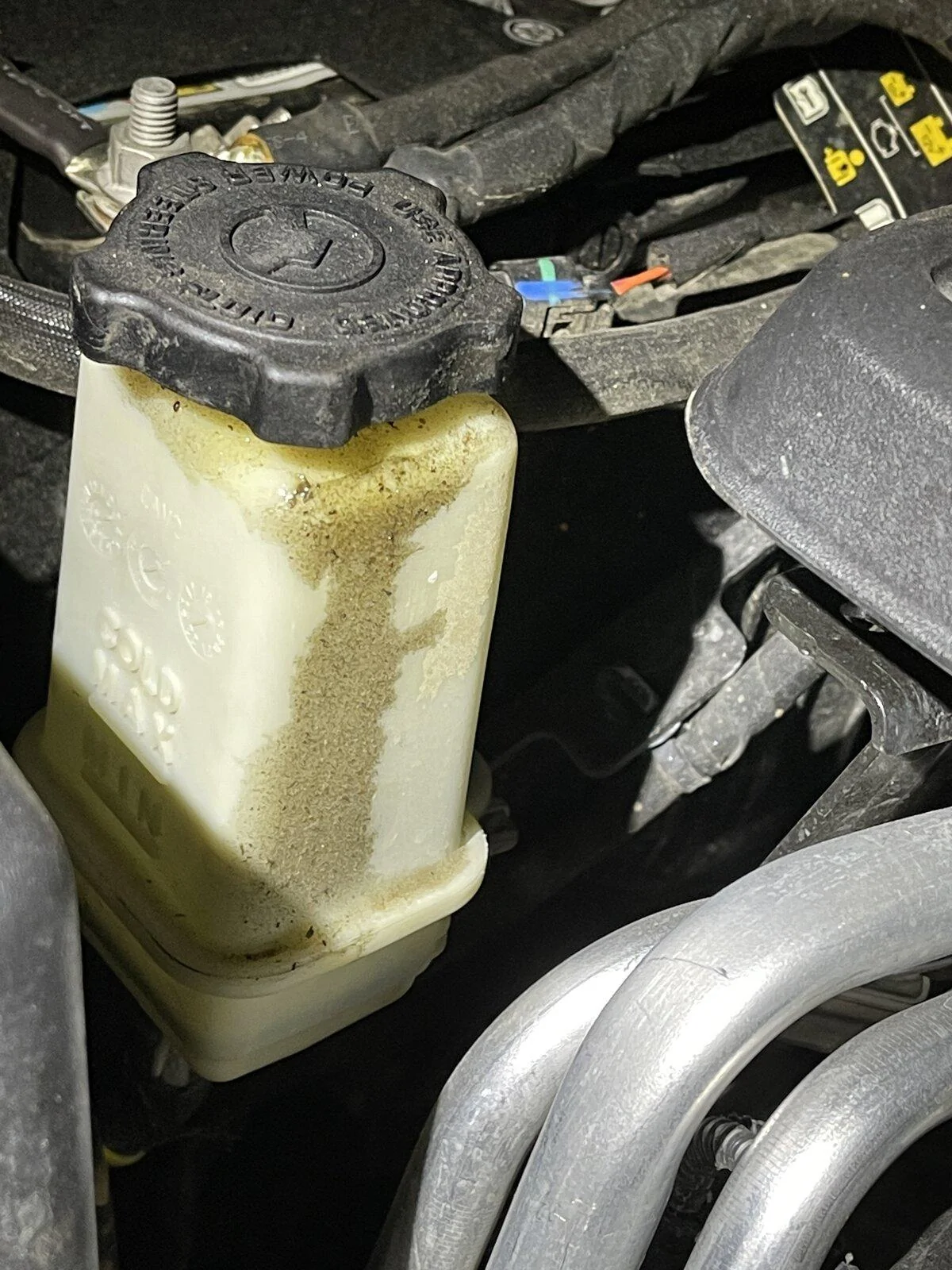

Looks like the techs forgot to refill my power steering fluid. Reservoir is bone dry now. Could have been that way since it started or a slow leak over the last 2-3 weeks.
I will have to go to the dealership first think in the morning to refill. Already have a 30/40k mile maintenance scheduled Tuesday so I will have them check for damage to the pump then
