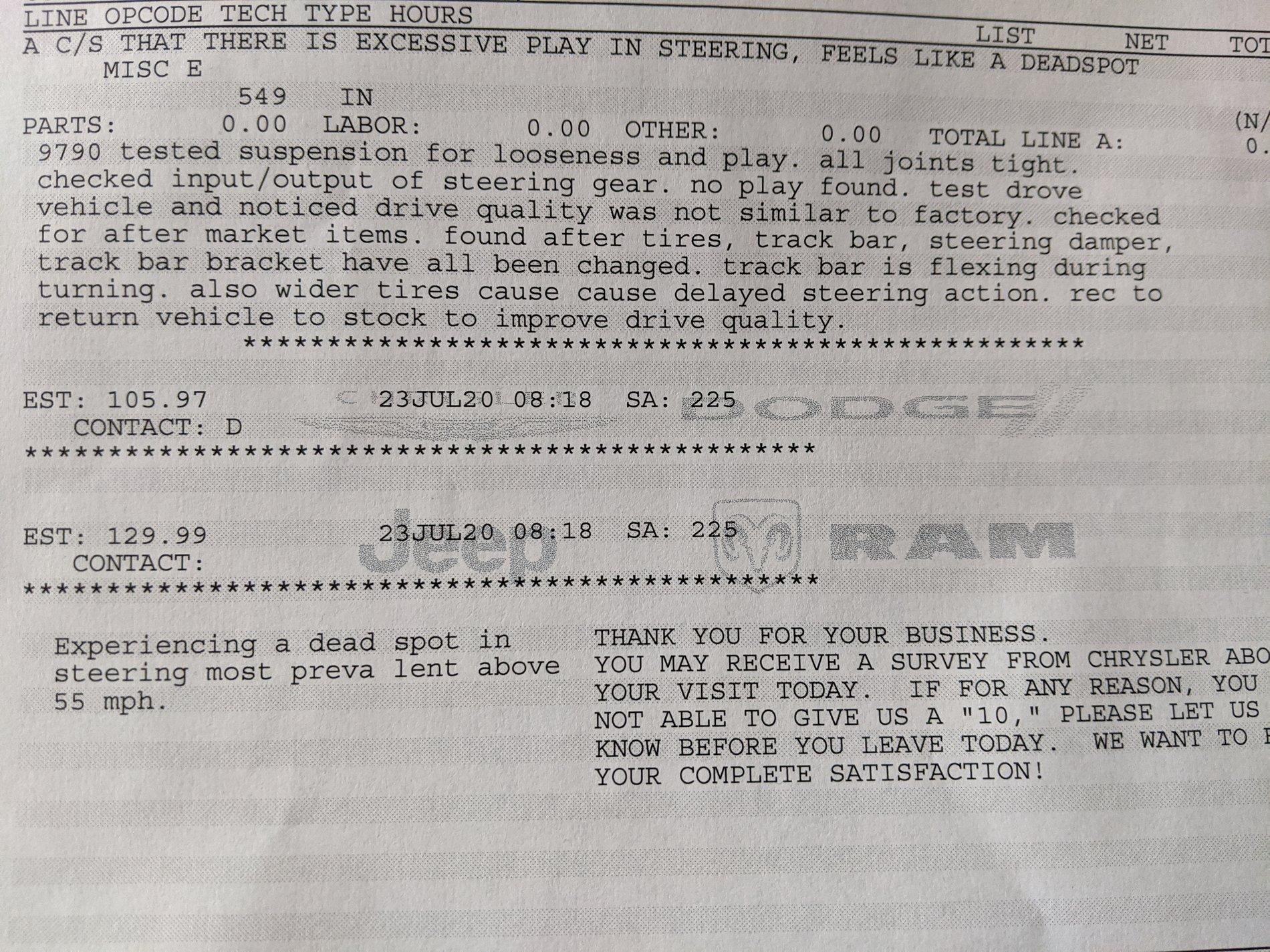

Why did you remove everything? Warranty void I'm guessing? have a synergy brace and a fox stabilizer. Do you think I should remove mine so they don't void the warranty?
This is what they wrote a couple of weeks back (pre-TSB). Didn't want to take any chances.
Interesting their recommendation was to return to stock to “improve drive quality”. My dealership installed my Mooar lift on it and immediately I complained that the wandering and steering seemed really worse off. Initially they said it was probably because it was now lifted. Fortunately the parts manager does read the forums and chatter online and said he’d heard about the steering issues in both the JL’s and JT’s, and since there was nothing official from FCA yet they installed what he referred to as a bandaid “for now” the Fox Steering Stablizer for free for me. He actually predicted back in January that they’ll probably come up with a computer software update as a fix but in the meantime he hoped the stabilizer would be a temporary fix. It helped for sure as it brought it back “to stock”.
That said, the inconsistencies between one service department and another is one that still baffles me. These steering issues exists as a spectrum from really bad to not as bad. Nonetheless, now that I know what it feels like to have one with the TSB fix, they should all drive equally well.
I spoke with the sales manager about this and said to him that reviews outside of what is discussed on the forums usually talk about the steering being off...having this fix should boost sales as the person on the fence may decided to not purchase because they don’t like how it feels to drive. Hopefully all new builds coming off the production line have this new steering box and updated software.

Maybe it helps that the dealer I went to for this work (not where I bought it) has modified JTs on the lot...... saw one just a few yards from the shop that was a sport - I looked that their sticker next to the sticker and it said "2" MOPAR lift, 17" wheels (they were black) 35" tires (and they listed something else)
So if nothing else I could have said - so what do you do if a customer had the issue with THAT truck? Tell them it's because of the lift and tires that YOU put on?
