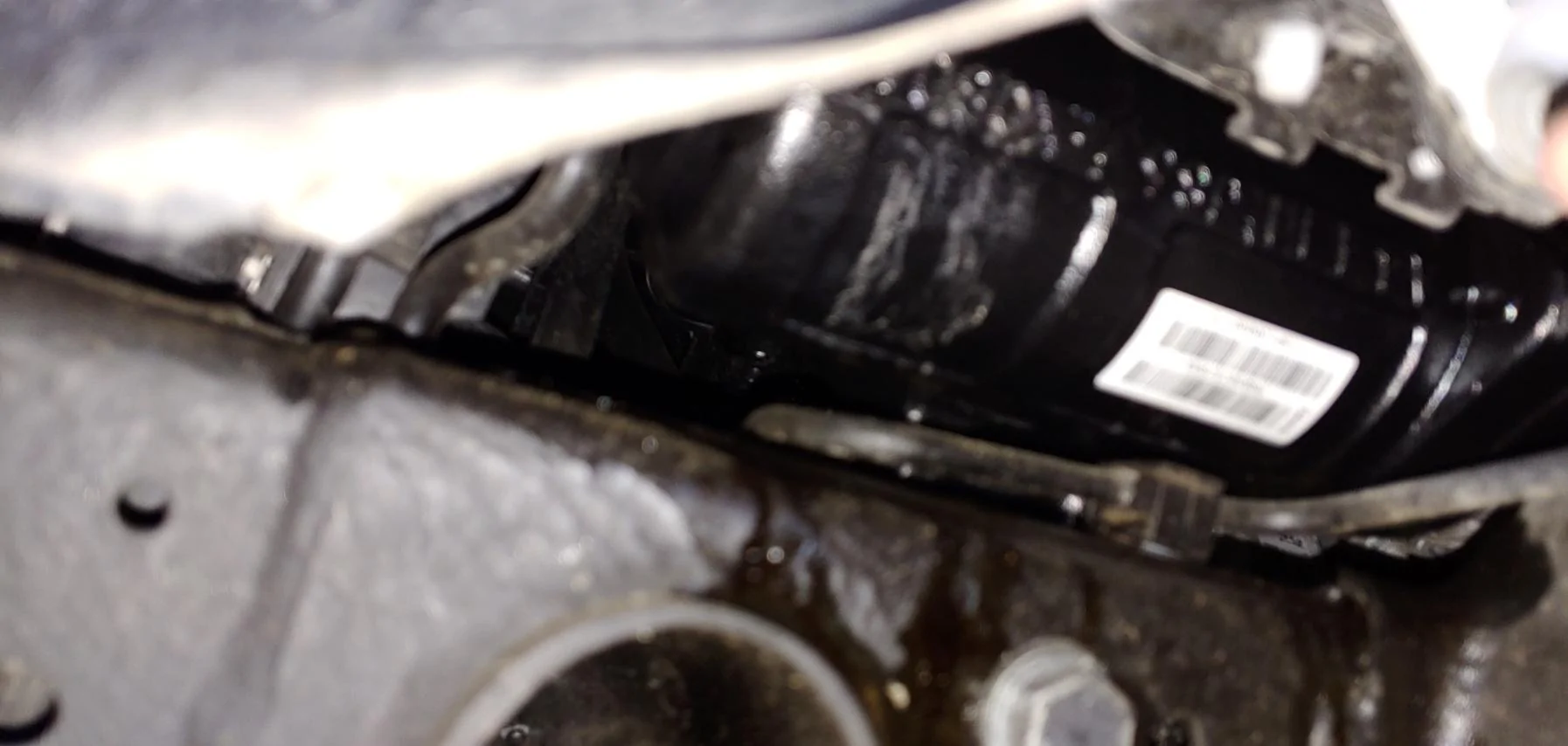

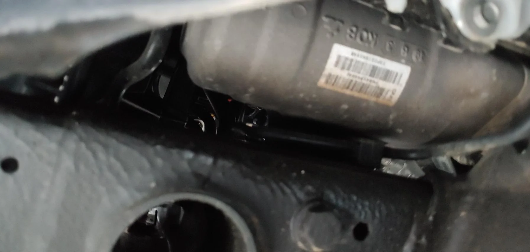

LoJac is spot-on. And that thin liner is easy as heck to pull back and look. It will show above the frame rail. The liner frankly barely covers it. NEW one will be black, original is cast aluminum and is more of a silver-gray color. And the neat part is that in most cases, the part number bar code is where you can see it.
got mine back couple days ago. if what youre saying is true, they didnt replace my steering box. but it also seems to handle a lot better from before.
40,496
54,011
I can tell also based on the fact the new bolts don't have undercoating on them. Aside from color, the castings look different as well.
Original top, replacement below -

That's an interesting point. Can you confirm that the new bolts are plain vs black? I am not sure the original bolts were replaced with mine. Aside from having the wrong steering gear installed, I want to make sure they put the correct bolts in.
My original bolts weren't black - they had undercoating on them because I have my trucks undercoated. (The only one I didn't had real rust issues.)
So they may be a dull finish, could even be greenish to gray.
They'll likely be a dull black phosphate -
The new steering gear requires new bolts because they are all 4 the same size while the original was held to the frame with two bolts a bit smaller than the other two. The new one takes 4 of the same size.
