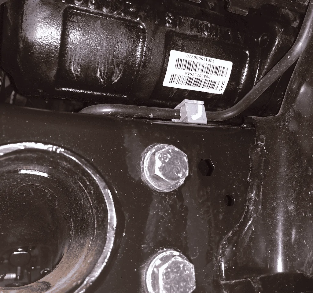

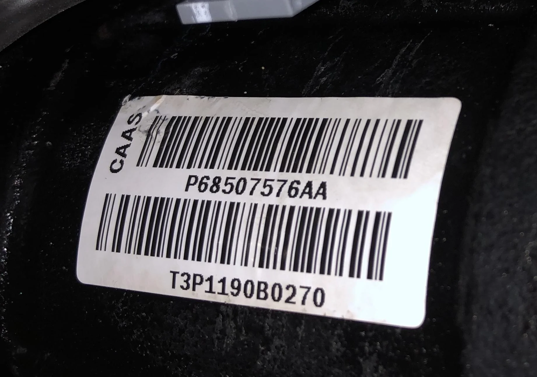

Just received additional information from the dealership. Technician denied the work?
Still have part number 49AE installed, and they are telling me the bulletin has been performed. Something is not right.

Truck is back. I would highly recommend addressing the issue if you have any concerns at all. Night and day difference....75 down the freeway and ZERO wondering. :champagne::champagne:
UPDATE - I forgot to add that I DID take my tazer mini out for this procedure.
@TSB 08-074-20
Jeep Gladiator New JT Gladiator Steering Issue TSB 08-074-20 (for "Improved Steering Feel") IMG_3745
Jeep Gladiator New JT Gladiator Steering Issue TSB 08-074-20 (for "Improved Steering Feel") IMG_3747

Hey I wanted to update the steering box on the ‘21 is the new version. My experience driving it home (500 mi) from the dealer... the steering felt almost too tight. If you even thought about turning the wheel it turned! I t was a bit of work, lots of correction on the highway. Now, it may be I’m just not used to it yet, I’ll give it couple weeks, and see how it is.
What is your MDH #? It's on driver door frame.
