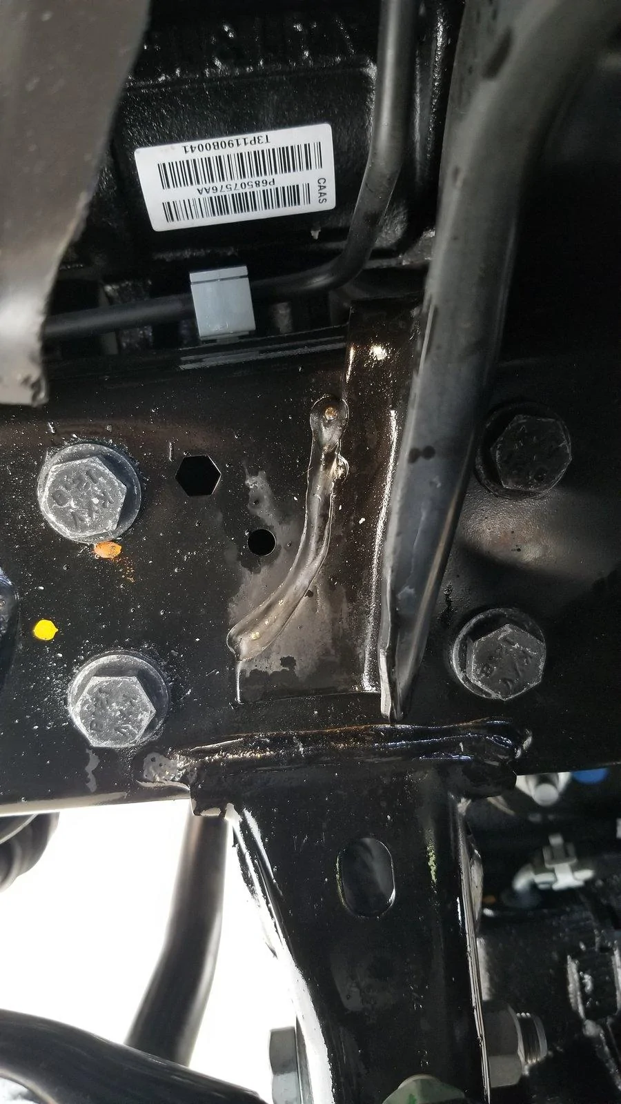

Just picked up my Jeep today. For me, it is a night and day difference. I didn't realize how bad it was. The steering has a much more firm feel than before (like when I had the Fox stabilizer on it), and there is no play whatsoever. They did perform an alignment and center the steering wheel. It drives like a different truck. It feels new again. It tracks straight and does not wander all over the road. I had ordered a Falcon adjustable stabilizer, but I'm considering returning it. Kearny Mesa CDJR is awesome. A shout out to Bill (Service Dept also has Will and Billy)! They hooked me up with an Uber ride home and back. The steering gear was overnighted, but the bolts took about a week. Well worth the wait! Below is a picture of the new steering gear and the four steel mounting bolts.

Well this is unacceptable ... Now I am jealous that your tech cared enough to get a new nut and mine just hung me out to dry ...
OCD kicking into high gear ... Someone help me ...
My nut is not red !!!!! Oh the humanity ....
Sooooooo, You want a red nut???
