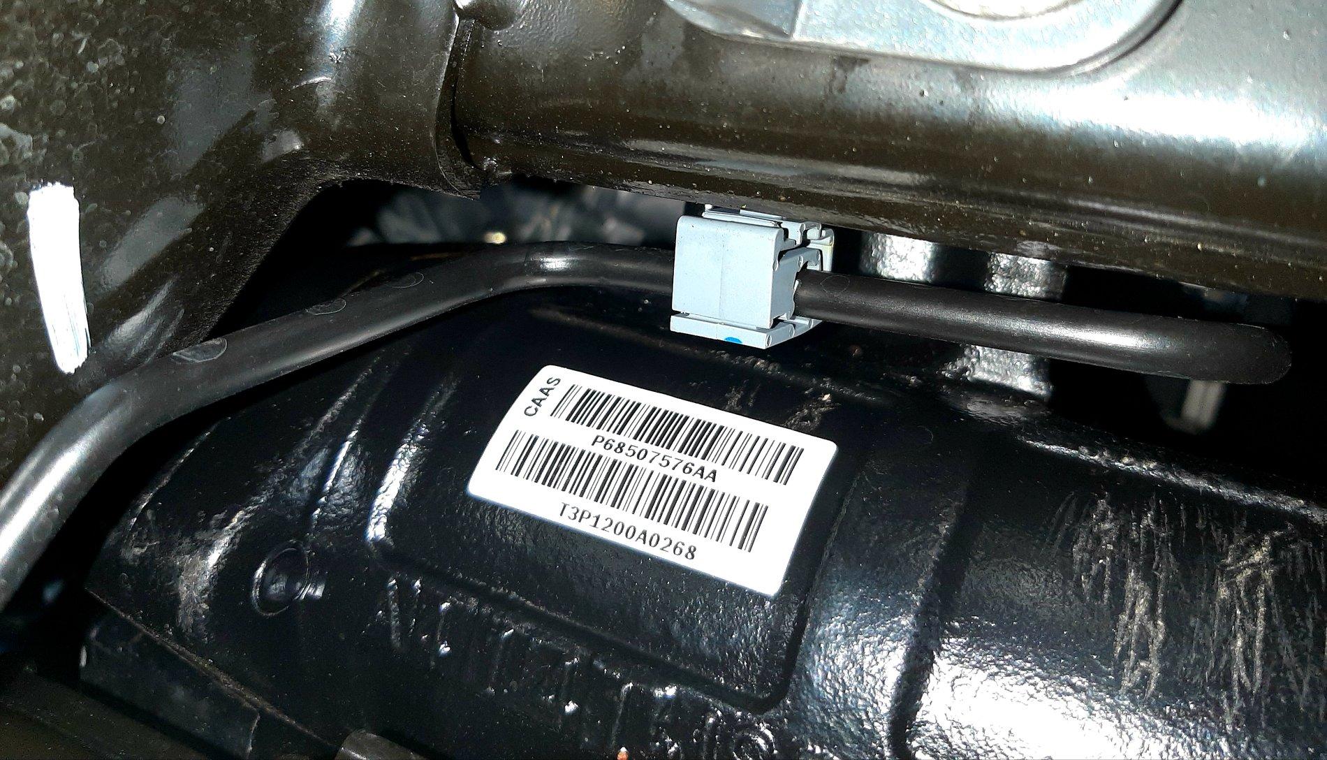

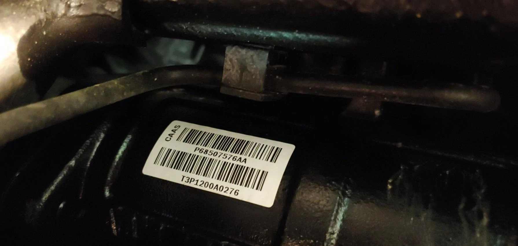

Seems like EVERYONE should take a photo of their new steering gear before leaving the dealership and checking to ensure it has the correct number.............After seeing a couple of folks here with the wrong one, I decided to check.
I really wish these had a quick-ratio gear but it is what it is, these aren't sports cars.
There is a one character difference between the JT and the Wrangler 2 door gear. And three are listed in the same chart, easy to mess up. Yup, maybe everyone should check.

Good lord now I am so pissed.
I went under the truck just to check based on this information on the forum here.
Guess what!
Wrong effin part!!!
These fools actually installed a JL steering box. You have to be friggin kidding me!!!!!
3rd trip back to the dealer. I'm a nice guy but I gotta tell ya, I'm getting close to losing it.

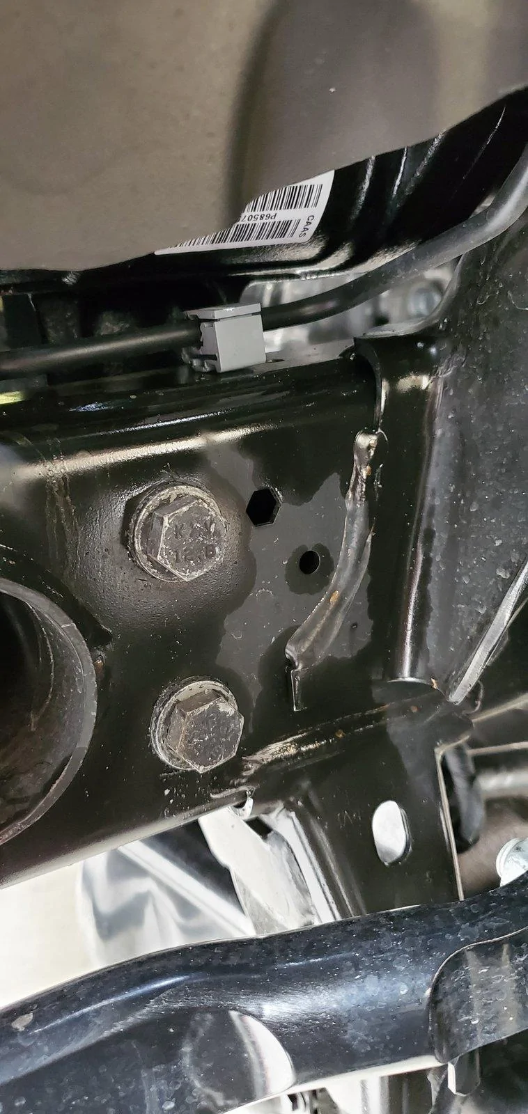

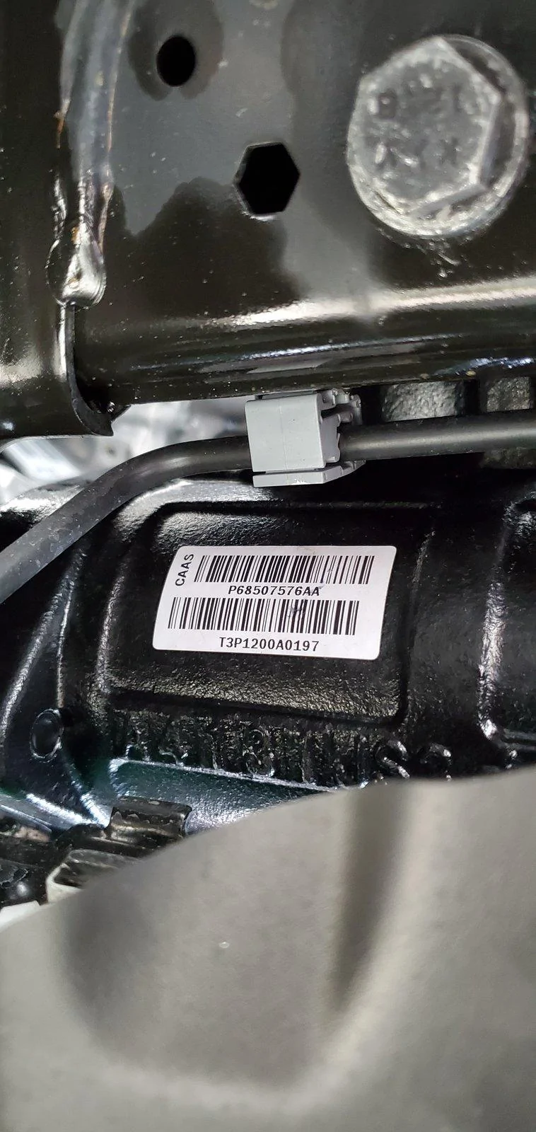

I know it's been said before but holy hell the new steering box is amazing! I don't live far from the dealership but just the short drive home was noticeably different in a good way. The whole truck feels different in every aspect. I wonder what all the programming update changes.
Pic of my new box and the new bolts, can easily tell the new bolts from the old.
Jeep Gladiator New JT Gladiator Steering Issue TSB 08-074-20 (for "Improved Steering Feel") New PS Box
Jeep Gladiator New JT Gladiator Steering Issue TSB 08-074-20 (for "Improved Steering Feel") 20200911_171141
