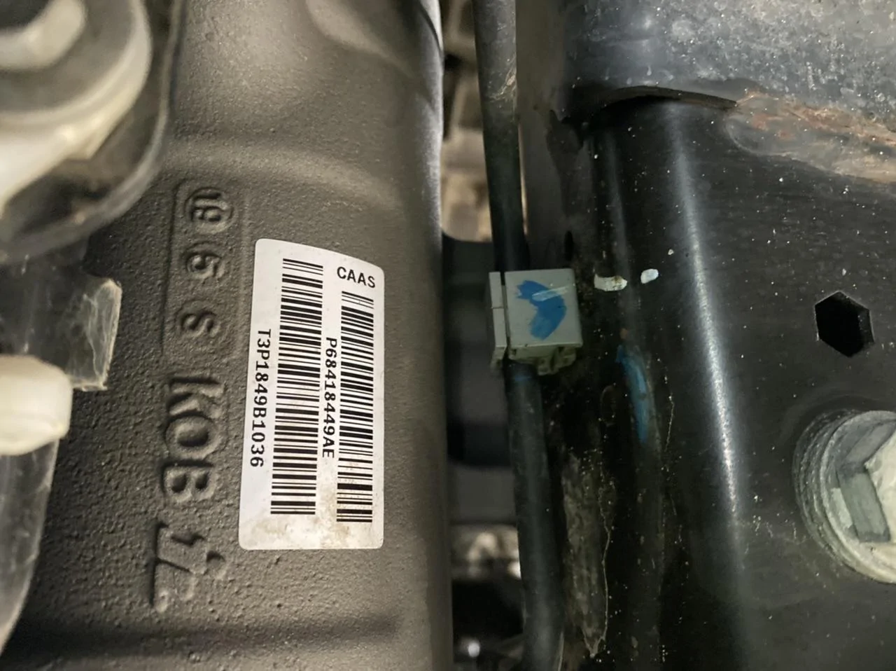

Good lord now I am so pissed.
I went under the truck just to check based on this information on the forum here.
Guess what!
Wrong effin part!!!
These fools actually installed a JL steering box. You have to be friggin kidding me!!!!!
3rd trip back to the dealer. I'm a nice guy but I gotta tell ya, I'm getting close to losing it.
Well I guess I should feel a little better since I’m not the only one with a stupid dealer...
EVERYONE NEEDS TO VERIFY THAT THE CORRECT PART FOR THEIR GLADIATOR IS INSTALLED BEFORE THEY DRIVE OFF THE LOT !!!
What pisses me off is that I brought in the TSB and showed it to them...

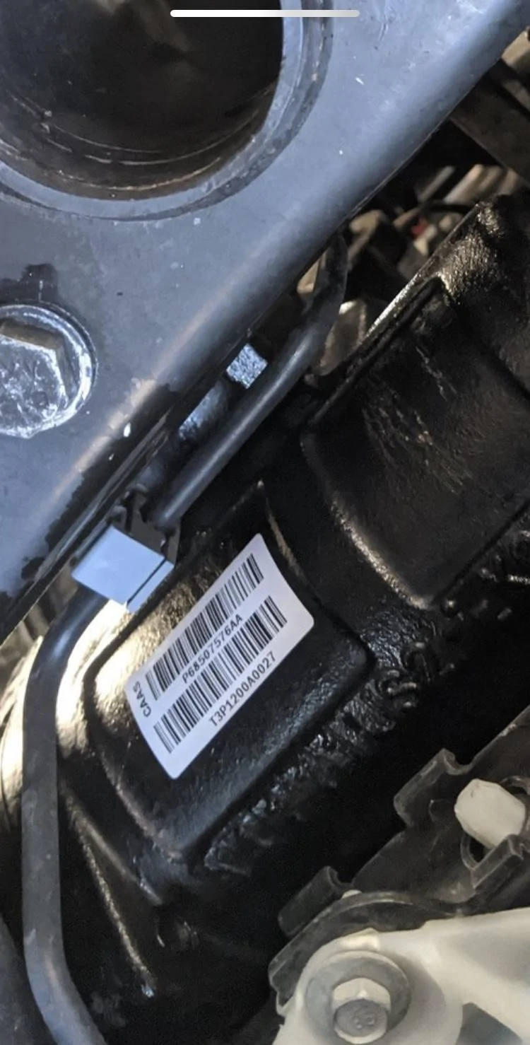

Could someone tell me if this gear installed by my dealer for the tsb is the proper one?
Jeep Gladiator New JT Gladiator Steering Issue TSB 08-074-20 (for "Improved Steering Feel") 1B42691D-AA57-41F2-83B9-6C2F5289A78D

Took my JT to M&L Motors in Lexington NC yesterday for the steering issue. Brought the TSB number with me as well (they can look it up, I shouldn't do all their work). Also had heating/ cold air issue checked out. One hour later, tech found no code issues, all were without error. Heating issue was corrected, due to incorrect setting causing one vent to blow cold air after a shirt period. Even though tech found no error codes for steering and no recalls or campaigns had been issued, my new parts were ordered for the TSB. I'll be called as soon as they are in to complete the repair. Dealer gave me no issues about correcting the problem or questioning the TSB. I will update once I get the repair completed.

My take is simple. And people like @ShadowsPapa are not who I am talking about. If I could get someone like that to work on my jeep I'd be a happy man.
The typical people (at least in my personal experience) at dealer service departments don't care much and are sloppy.
In my case, I simply needed the tsb done. One trip for diagnosis and one trip for the work.
As it stands now, It is going to take me a minimum of 4 trips to get this done.
Trip 1: diagnosis
Trip 2: all day to install new gear and screws
Trip 3: return trip to recenter steering wheel that wasn't checked on the 2nd trip.
Trip 4 (future): return trip to get the proper steering gear installed as they installed the wrong one the first time.
The first guy ordered the wrong thing, the second guy didn't check and installed it anyways, the same guy didn't check the steering wheel after he aligned the truck. The third guy aligned the steering wheel (mostly).
No one actually did their job with any degree of professionalism or accuracy. All of it to my detriment.
This dealer literally did every step wrong. Every step. And the sad thing is that if I had a lift, I (as an unskilled member of the public) could have done all of this myself the first time.
These people can't be this dumb. My conclusion is that they just don't care enough to pay attention.
