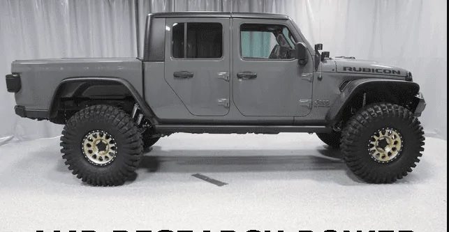

Dropped it off this morning, and now the dealer called and said the bolt didn't show up, and it's scheduled for delivery tomorrow. So they'll keep the Jeep a day or so; not the end of the world I suppose.
I think if the pattern of the missing bolt turns into a long run I'll see if I can borrow their JT on 40's for the time being.
