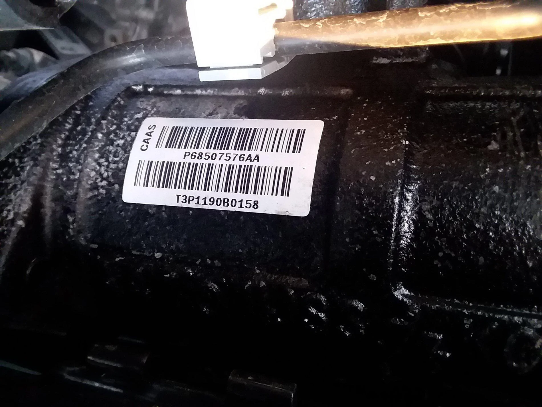

Just went to go check my truck with the new info of wrong gear installs. I'm happy to say my PN ends in 76AA, woot! Still drives much better.
