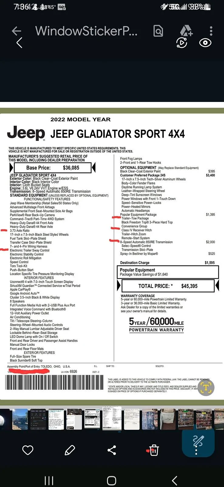

Hey guys! I've looked all over the threads here and on "way-a-life", and I can't seem to find my ACTUAL tow capacity for my truck. I contacted my dealer, they said 7,500 LBS, but I don't have max tow, my sticker says 3.73 gears with "tow package" and class IV hitch which should be 6,000 LBS right??? I've read that Gladdy's are only 4'500 LBS, and you need an overland for 6,000 LBS, or a Rubicon for 7,500 LBS.... wtf???

No my sticker says that I have "Tow Package" which should be 6,000 LBS right?

For most models, the tow rating for a gas engine and automatic transmission is 6000 pounds with a factory installed Tow Package, 4500 pounds without the Tow Package.
The owners manual should have a chart in it. The Tow Rating is generalized based on how the model is equipped from the factory. To get the specific rating for your truck requires the door sticker and some math calculations.
The 'legal' Tow Capacity for the truck comes from the door sticker and is determined by the factory and cannot be changed. The actual Tow Capacity is affected (usually reduced) by any changes made to the truck. Lift and Tires are the most common, and diminish the towing capabilities of the truck.

The 'legal' Tow Capacity for the truck comes from the door sticker...
The problem with this oft-mentioned statement is there is no tow capacity listed on any sticker anywhere on the truck, only the GVWR and payload are given. The GCWR isn't listed on any sticker either.

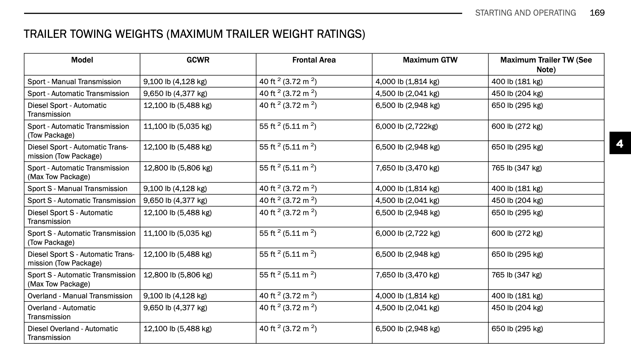

From your owner's manual, pp 166-171
The rated capacity is for a stock truck, and will be reduced by your tires and any other weight you've added from the stock vehicle.
