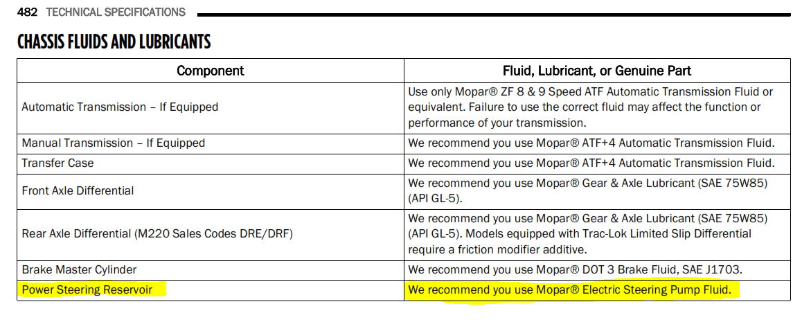

No you may not it's special power steering fluid for hydro assistant
NO - Never use ATF in modern PS systems. Talk about voiding warranty.
Since the 1990s, they've say not to use ATF. It goes clear back to the ZJ and WJ years at least
jeez. I went back and edited my first comment just in case anyone else decides to quote it, skip the rest of the thread where we discuss the correct fluid and hop on at the end to say “WRONG” ?

Fluid for the EHPS systems isn't cheap.
After they replaced the second steering gear on my 2020, I noted the fluid was low after a couple of days. I was in the area and stopped in and suggested "the air worked out, and now it's low". The guy walked inside, grabbed a bottle of PS fluid, filled it to the full mark and handed me the rest of the bottle. 20-some bucks a bottle. Fine, now I have some spare which I hopefully will not use any time soon.
Gone are the days of buying cheap red ATF and dumping it in the PS pump. (but then gone are all of the problems those systems had, too)
It's been a long time since I saw ATF specified for a PS system. As I recall, even the ZJ and WJ specified PS fluid and said to not use ATF or ATF+4. That's going back into the 1990s.
The exact same thing happened with me. Had steering box replaced to new steel, low fluid days after and tech handed me a slightly used bottle to keep.
