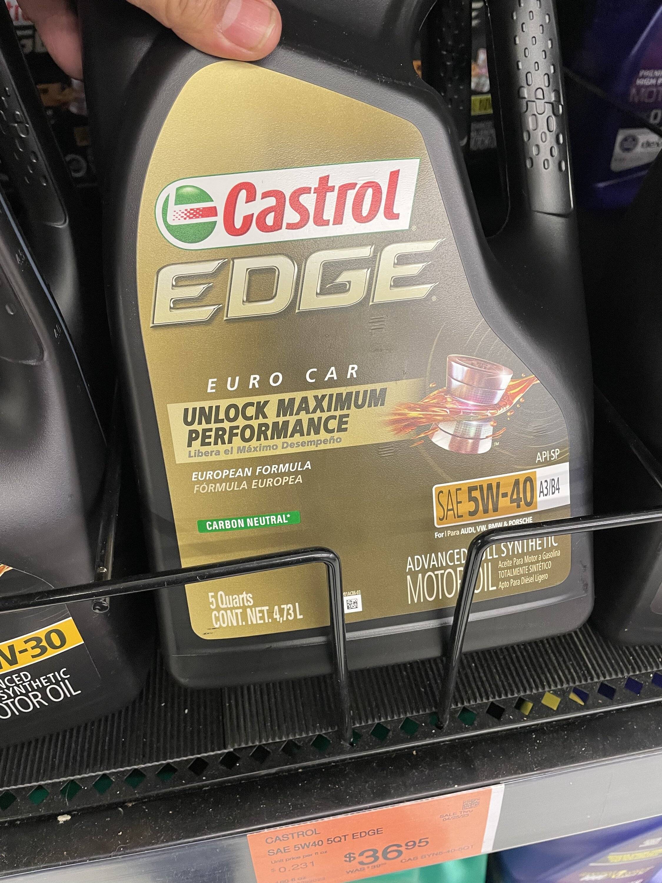

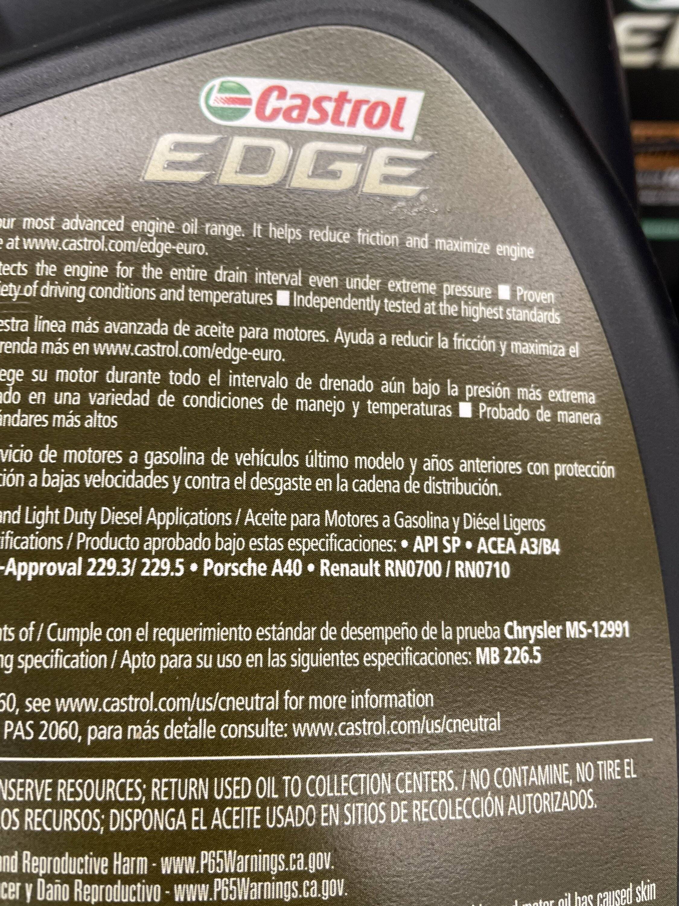

rharr
May 6, 2021
29
2,044
2,805
Tucson, AZ
The cert is in Spanish so there is probably a loop hole in the warranty that voids everything because it's not meant for US based stuff :giggle:
In all seriousness, good find
