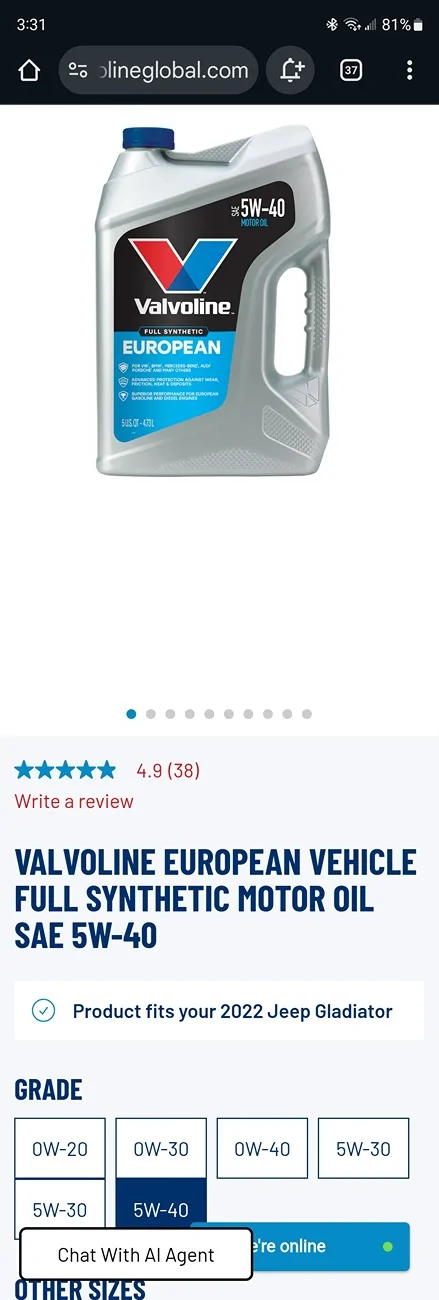

On Valvolines website, if I look up oil by my 22JTRD it list the Euro as an exact match and their only option.
Jeep Gladiator Official EcoDiesel Oil and Filter Recommendations Screenshot_20260120_153108_Chrom
Not arguing, just showing.

And technically, they're correct. Per the owner's manual it's recommended to use a 5W-40 synthetic oil that complies with MS-12991, but it requires the oil to be API SN. So Valvoline is correct in saying that oil meets the requirements for your ecodiesel, even though it doesn't carry the recommended MS-12991 cert.

On Valvolines website, if I look up oil by my 22JTRD it list the Euro as an exact match and their only option. Not arguing, just showing.
Valvoline reformulated and removed the MS-12991 designation from their Euro 5W-40 oil to their SynPower MST 5W-40 oil. They have since removed the MS-12991 from the MST SynPower as well. Interestingly, the Valvoline SynPower MST is a C3 oil, which offers pretty much the same performance requirements as MS-12991.
