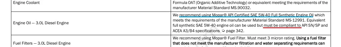

What I've been trying to drive home is that word choice in technical guidance is important. I spent an entire career in maintenance dealing with this on a daily basis. When one says something is required, it means there is no other option, ie, the guidance must be followed. When it says recommended, it means preferably you should go with the stated option but there is at least one other option that is permitted.
At no point have I ever seen nor has anybody been able to provide evidence where MS-12991 is required, it is always listed as you show above, as a specific recommendation for the Mopar oil. Even in the case of the 2023 rewrite of the owner's manual, it clearly differentiates that the Mopar oil is recommended but follows that up with the statement that other oils may be used but must be compliant with the specified API category, with the addition of also now including an ACEA rating.
This is my first time to see this literature. I would agree that the 2023 revision clearly differentiates between the MS-12991 specification and the API SN/SP and ACEA A3/B4 spec. Beforehand, engineering and the MasterTech told us to stick with MS-12991 oils for warranty purposes. But this latest revision would give owners more flexibility.
That literature came out sometime mid 2022. Mine 2021 manual stated required on 1 page, and recommended on another page. Jeep just couldn't makeup their mind lol.
