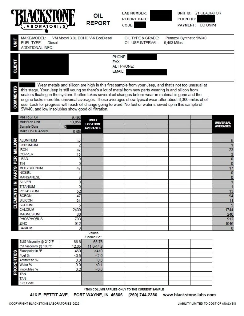

Here is my oil test. I would appreciate if anyone could translate it for me.
My first oil change was at about 4300 miles. This test was from my 2nd oil change at 13,856 miles which is 9,493 miles of use and oil life indicator said 5% . Penzoil Synthetic 5W40
Do any numbers indicate if the oil still had protective value to it or if I should be changing it sooner?

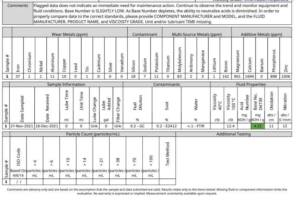

Here's my UOA for comparison. My intervals are much shorter.
