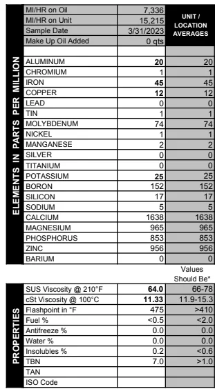

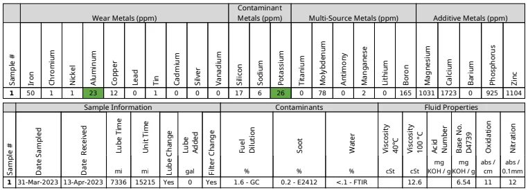

Sank
Jul 10, 2020
186
171
05 LJR, 22 JTRD
~7500 mi on oil, 15k mi on engine, using Penzoil Euro.
Planning to continue on 7500 intervals and on Penzoil Euro 5W-40. You oil experts can tell me what I'm looking for, but "seems fine" to my untrained eye. Thanks to @biodiesel for the encouragement to try it out.
Oil Analyzers:
Jeep Gladiator Official EcoDiesel Oil and Filter Recommendations 1683839295822
Blackstone:
Jeep Gladiator Official EcoDiesel Oil and Filter Recommendations 1683839236048
CrazyCooter
Tony
Nov 1, 2020
2,331
2,596
Far NorCal
Specialty Off Road Shop Owner
Oil Analyzers:
Blackstone:
That doesn't look bad either, but the viscosity is sheared down and ready to change. Crazy how the TBN varies so much between your sample and @NCJL. How long has your oil been in the engine (Time)? I would expect your wear metals to be slightly higher that his since he is running a bypass filter to pull more of the small particles out.
