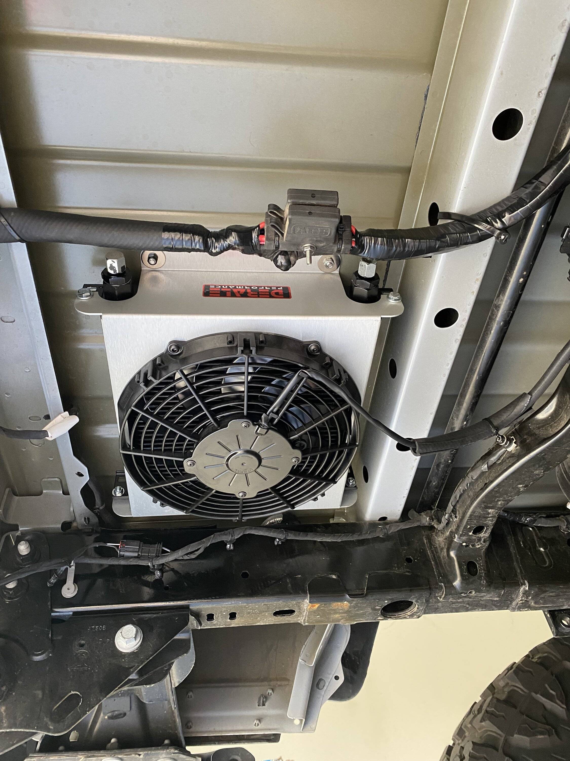

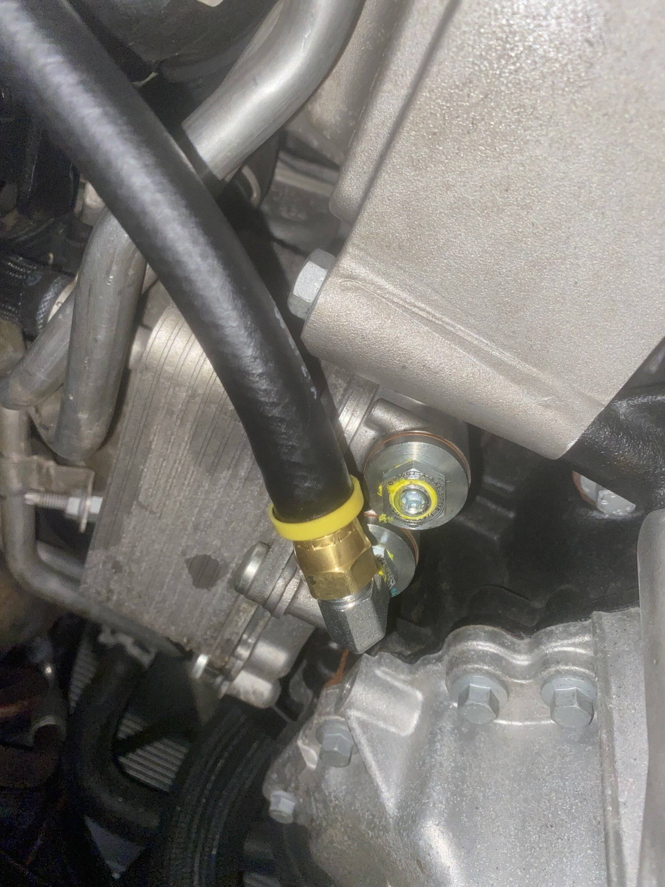

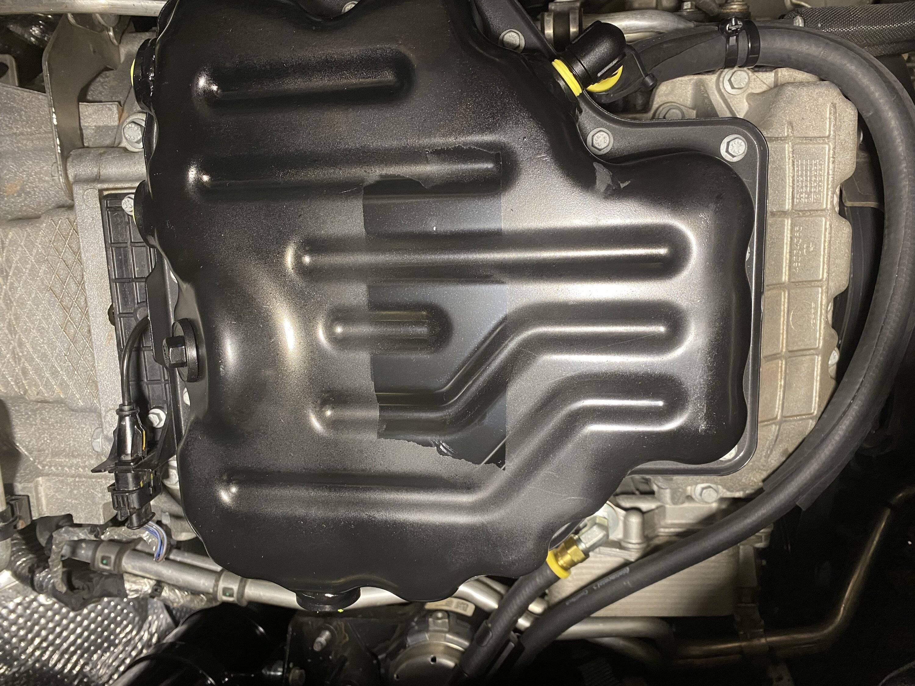

Yes I installed the ID bypass system myself, then made changes. I taped into the factory plugs at the bottom of the filter housing. (1/4” tap reduced to 1/8”). I also added an oil cooler. The return oil line is taped into the oil pan. All lines are 3/8. Total oil in the system is now 12 quarts.
Oil temps average up to 20* less with changes. Max oil temps with change is 243* for less than a minute when really pushing up a grade.
The Motul oil is already impressing me with the quieter sound of the engine. Noticed very quickly after change. Such a difference I now hear different sounds from the engine that was not noticeable before. Been driving diesels for the last 20 years.
I installed the muffler delete tail pipe to make room for the cooler under the bed, but I have not pulled the trigger yet. It will be in the 90's this week and I'm towing the RV next week, so oil temps will be a concern again.
Again, concerned about warranty denial even though I'm trying to help relieve stress on the engine by lowering the high temps.
