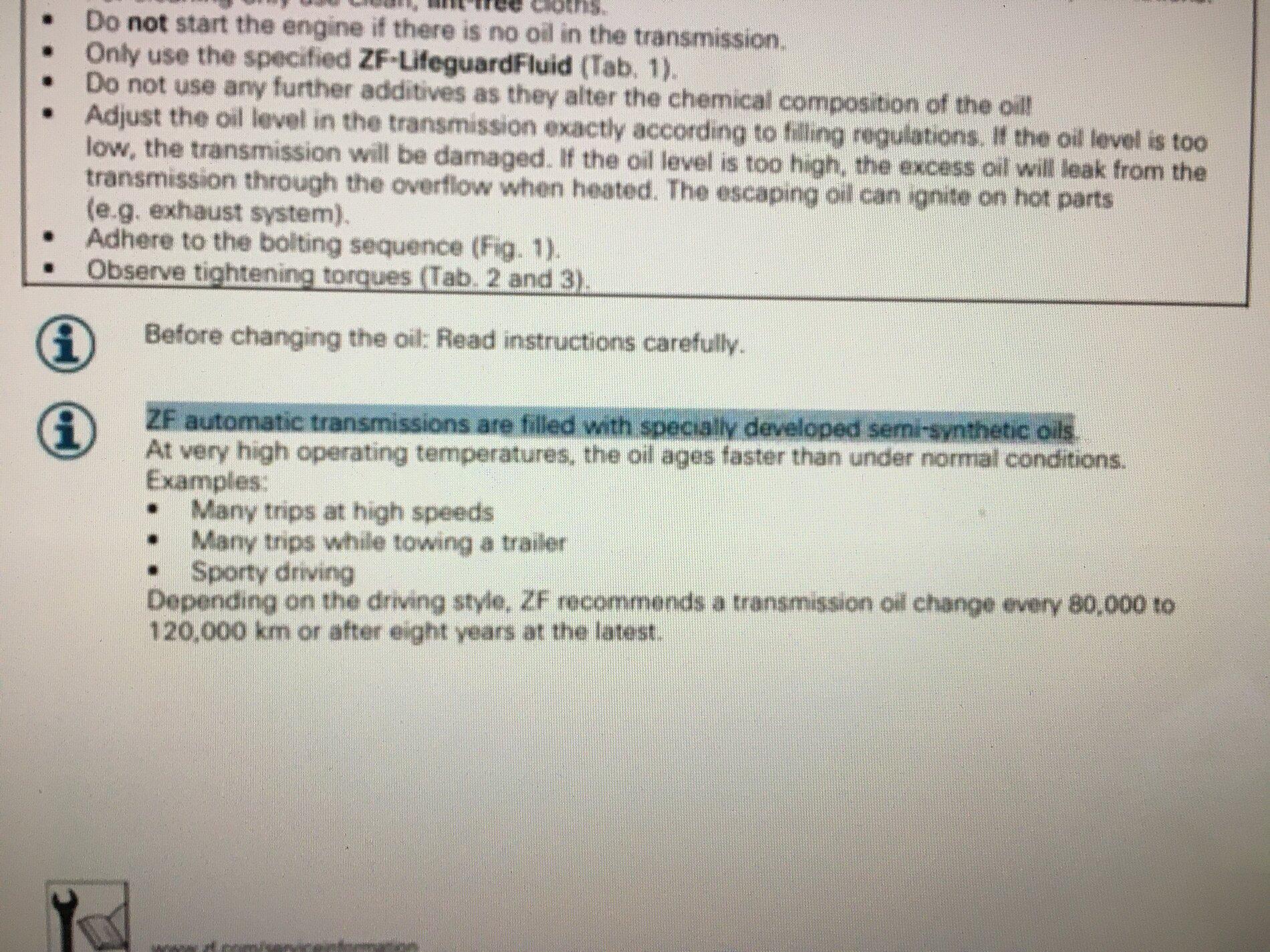

I changed all my oils except the ZF 850re transmission at 1000kms. I pulled a sample and took it to the lab for my proof I did my own changes. Lab result came back on the engine oil to say there is a “trace engine coolant in the oil”. I have 4000kms to go for the next oil change and will see if there is coolant in that sample. In my case, I’m glad I changed it early and I have the lab results they can’t argue. I use Amsoil. I will also be swapping out the ZF Life Guard 8, (“life time” marketed crap SEMI SYNTHETIC mopar oil) from the transmission next month to Amsoil Signature 100% synthetic ATF and again will have the lab results to prove what came out.

Do what you want but I wouldn’t mess with the transmission oil, these are pretty complicated transmissions and don’t require frequent service.

I agree and I certainly would not use any fluid that is not expressly approved by Jeep if you think you may have an issue...

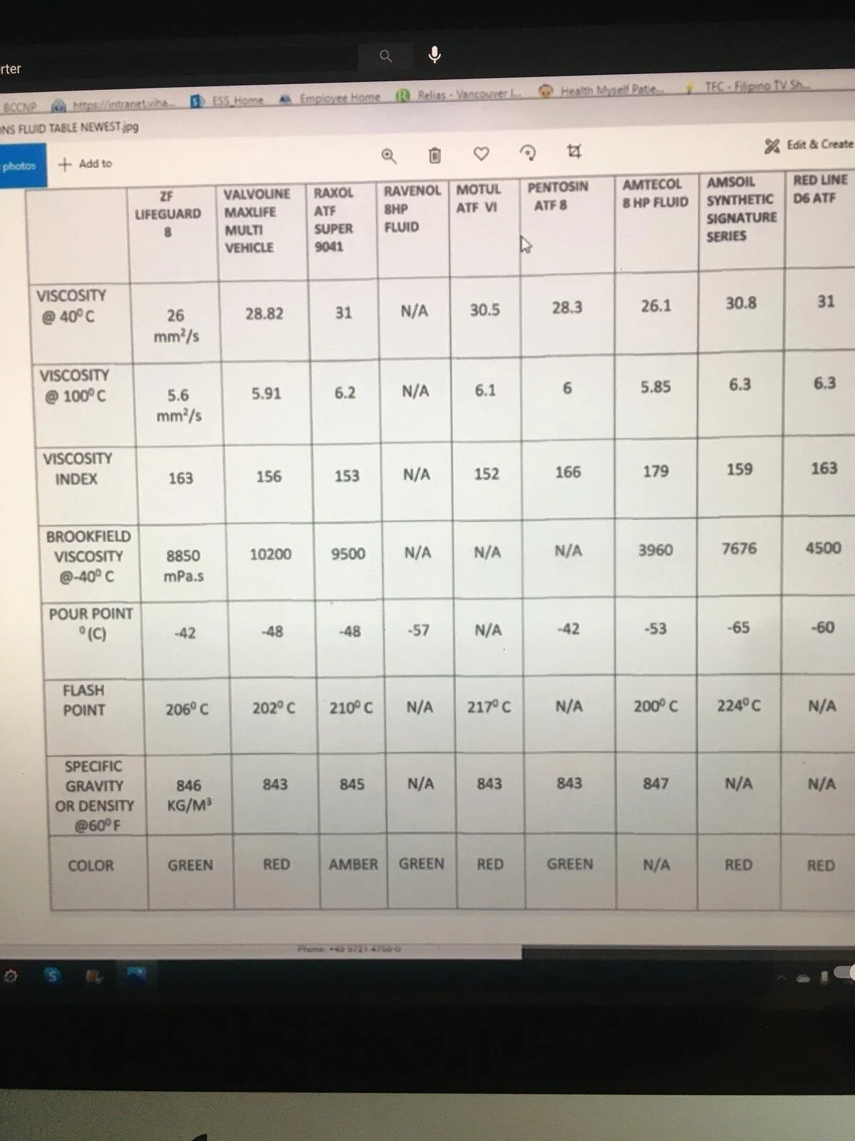

No issues yet but I’m also not wanting any down the road so just upgrading the oil. Got the approval from Amsoil that the Signature ATF is approved for this tranny. Also, when ordering the pan/filter/gasket from Mopar, the parts guy ask why on earth would I want to change the oil over with so few kms??
I started reading him the data numbers of his ZF Life Guard 8 oil and Amsoil’s data numbers and half way through the data he says “STOP, I get it, you’re good!”
Here’s the data sheet.

Is Amway going to replace your tranny or pay for repairs if there is a fluid related problem? I don’t see what their approval matters.

Amsoil stands behind their customers and their product. I can guarantee that if their oil was not compatible with the transmission or for any other oiled application they would tell you and it would be stated and documented.
