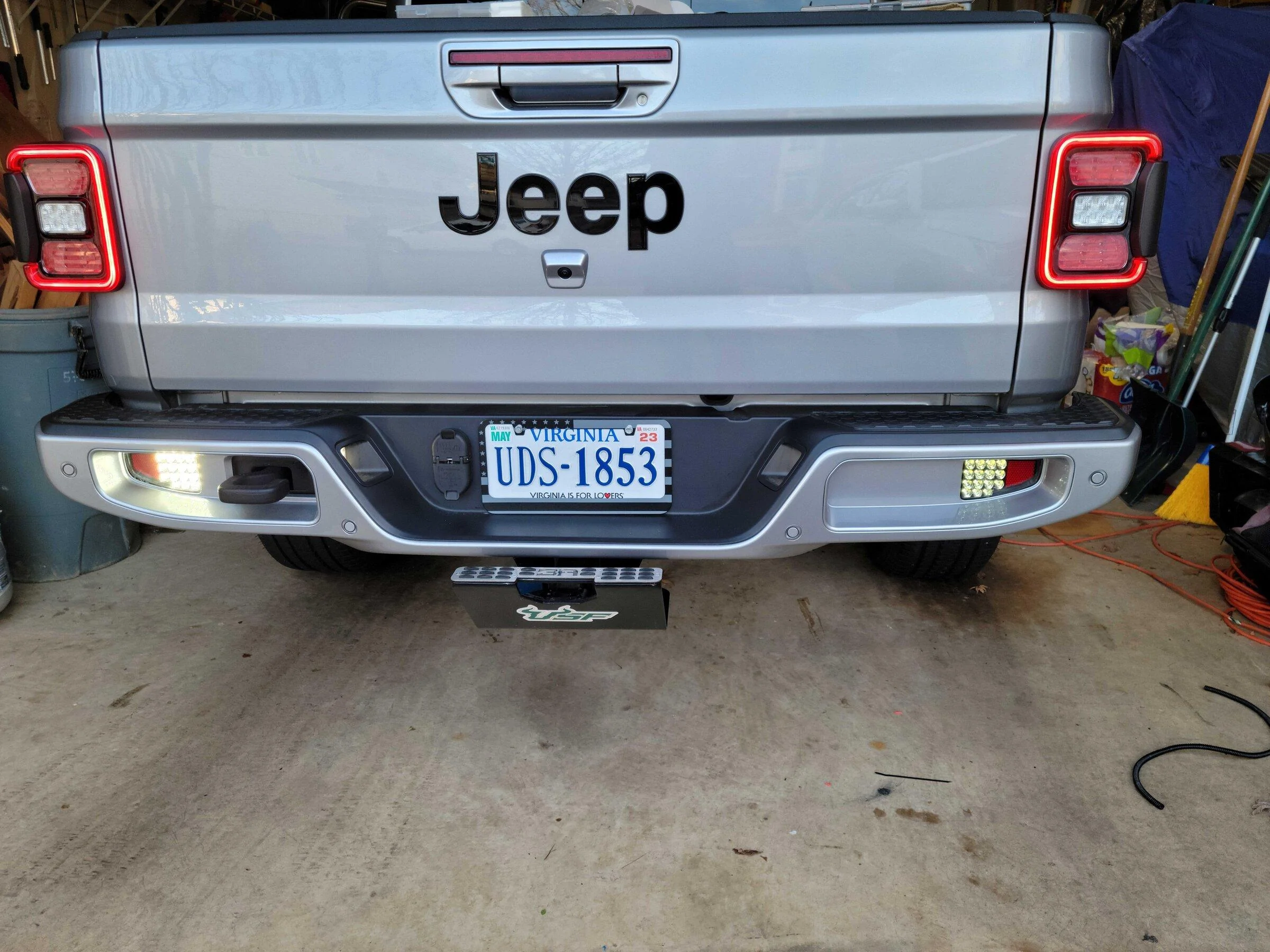

Installed my flush mount lights last night. I also have the Oracle bumper lights. No issues at all. My truck was halogen that is now all LED. I had some aftermarket LED taillights in for several months that I used J-scan for. Swapped to the flush mounts without the resistor and no problems.

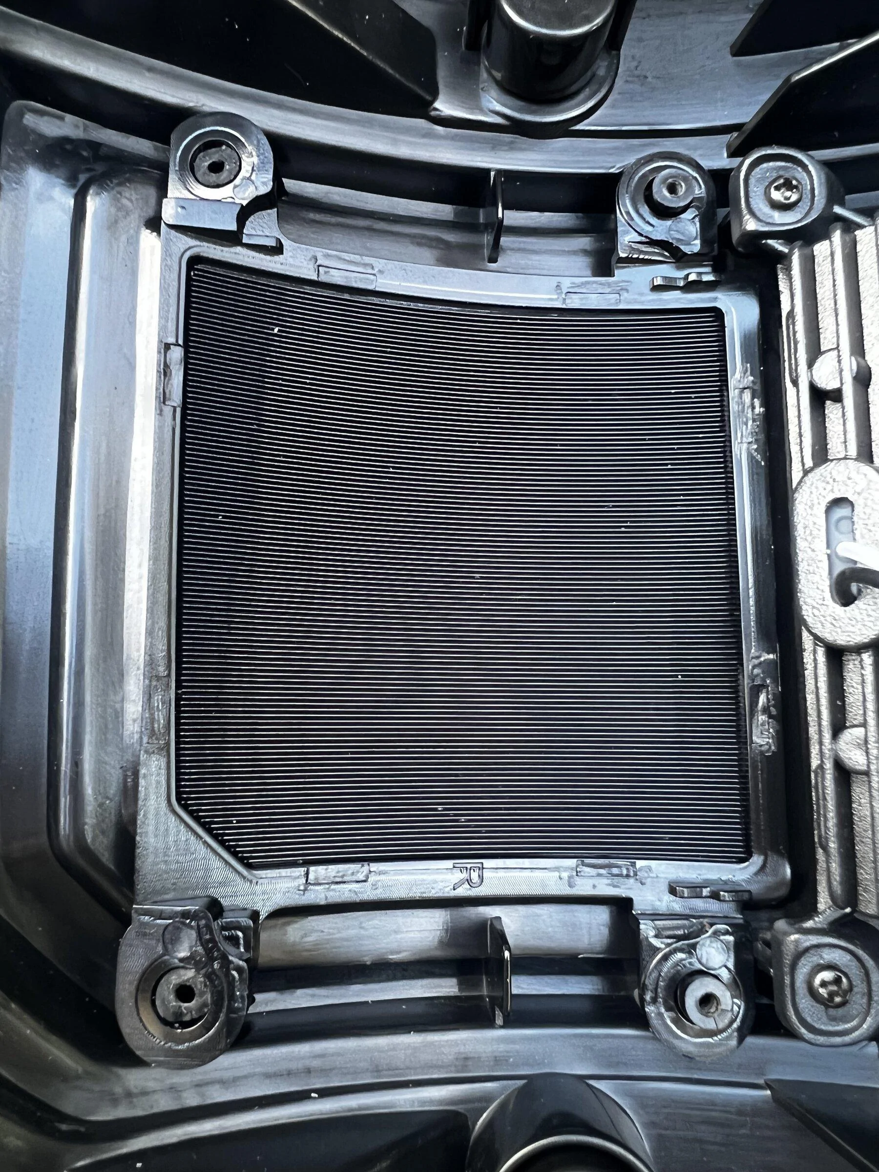

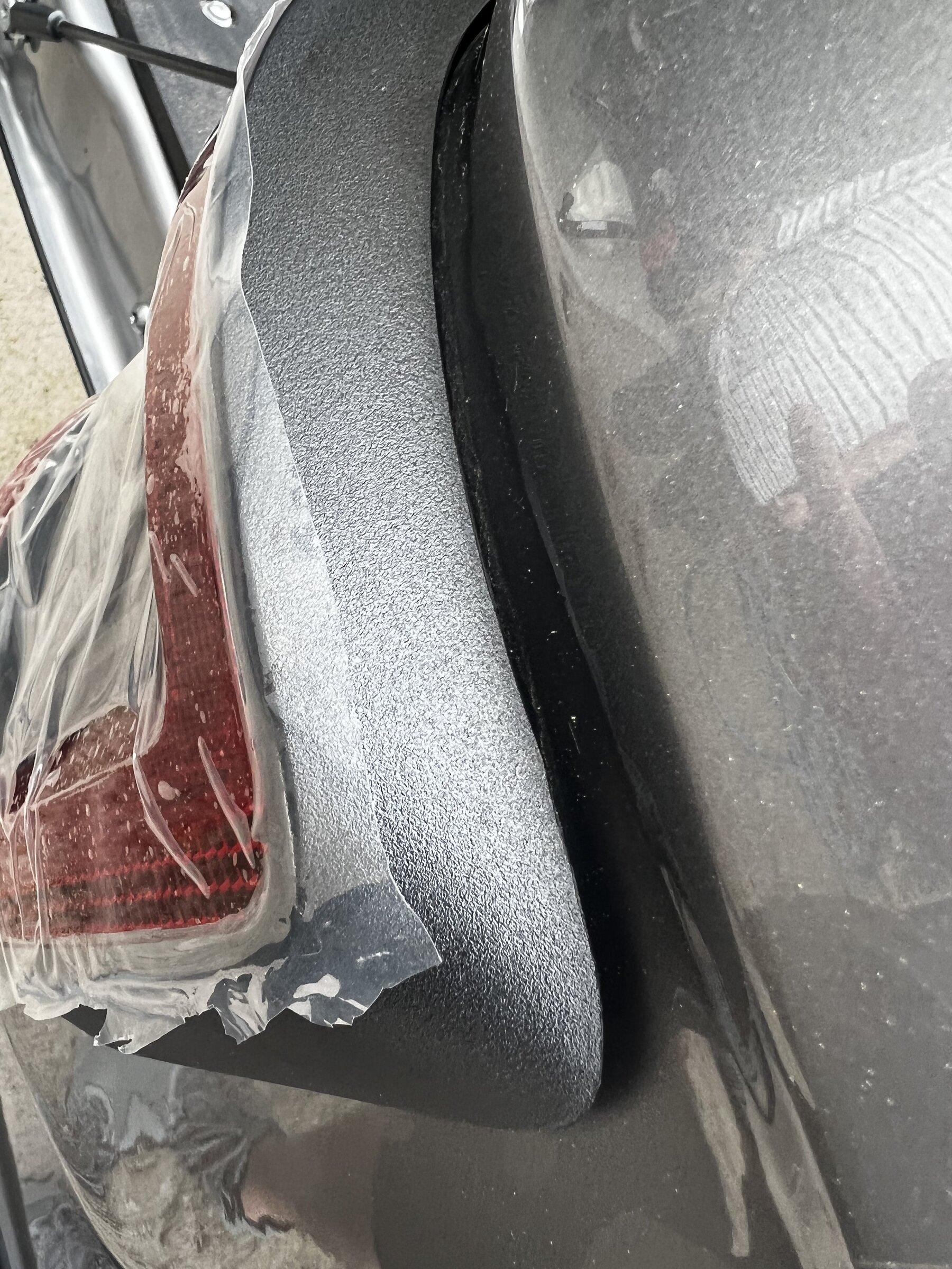

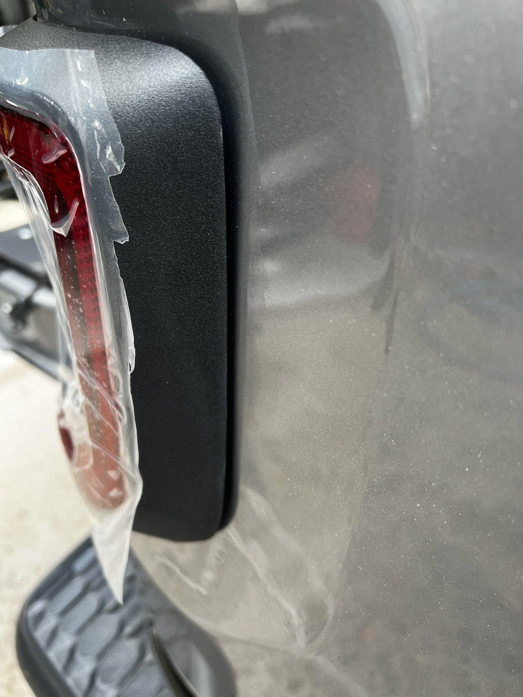

Waited 4 months for mine to arrive - no worries, I know everyone else did too. Straight out of the box, two standoffs were broken. I installed anyways to check fitment that many early adopters had and as you can see, there's major fitment issues. I've contacted Oracle and sent the same pictures to them 3 times and they claim they're not getting them. I haven't heard back from them in a week.

Considering they ship in plastic bags I'm surprised mine didn't come damaged.
Gap was also present on mine until the inside the bed bolts were tightened. I push forward on the lights while tightning the bolts. Seems to do the trick.
Hi Chris, I'm sorry to hear about the trouble you're having getting photos to our team. We have a high volume of customer service requests right now, but we want to make sure we are providing help in a timely manner. I am going to PM you in a moment to get your order information and get your photos over to a specialist to assist you with your installation.

Mine fit pretty well, but I did really lean on them when snugging down the screws at the tailgate.
