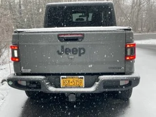

Hello all, Have both the reverse lights and flush tail lights, replacing the halogens, installed using the harness and had issues with reverse lights going out, used jscan to change everything to LED, fixed it for a week, now having a weird issue with the reverse light on the left tail light on during normal driving conditions. See picture. Any idea how to resolved?

Hey Steven,
Definitely something going on with the way the JSCAN is set here. Go in and reboot to factory. Then, follow these instructions from the JSCAN site:
1. Go to Adaptation
2. Tap Search (Magnifying glass)
3. Type "diagnostics"
4. Disable "Diagnostics Present" for the tail lights
Slpresto99
Steven
Apr 23, 2021
Albany NY
21 Gladiator Sport S
Healthcare
Hey Steven,
1. Go to Adaptation
That worked. Still concerned about the reverse light that was on the left taillight during normal driving and was still there when I switched itto the right side but after messing with the harness it went away. If that comes back I would like a replacement light and harness. Shouldn’t have to deal with these types of issues on a new product if it’s not working properly.
