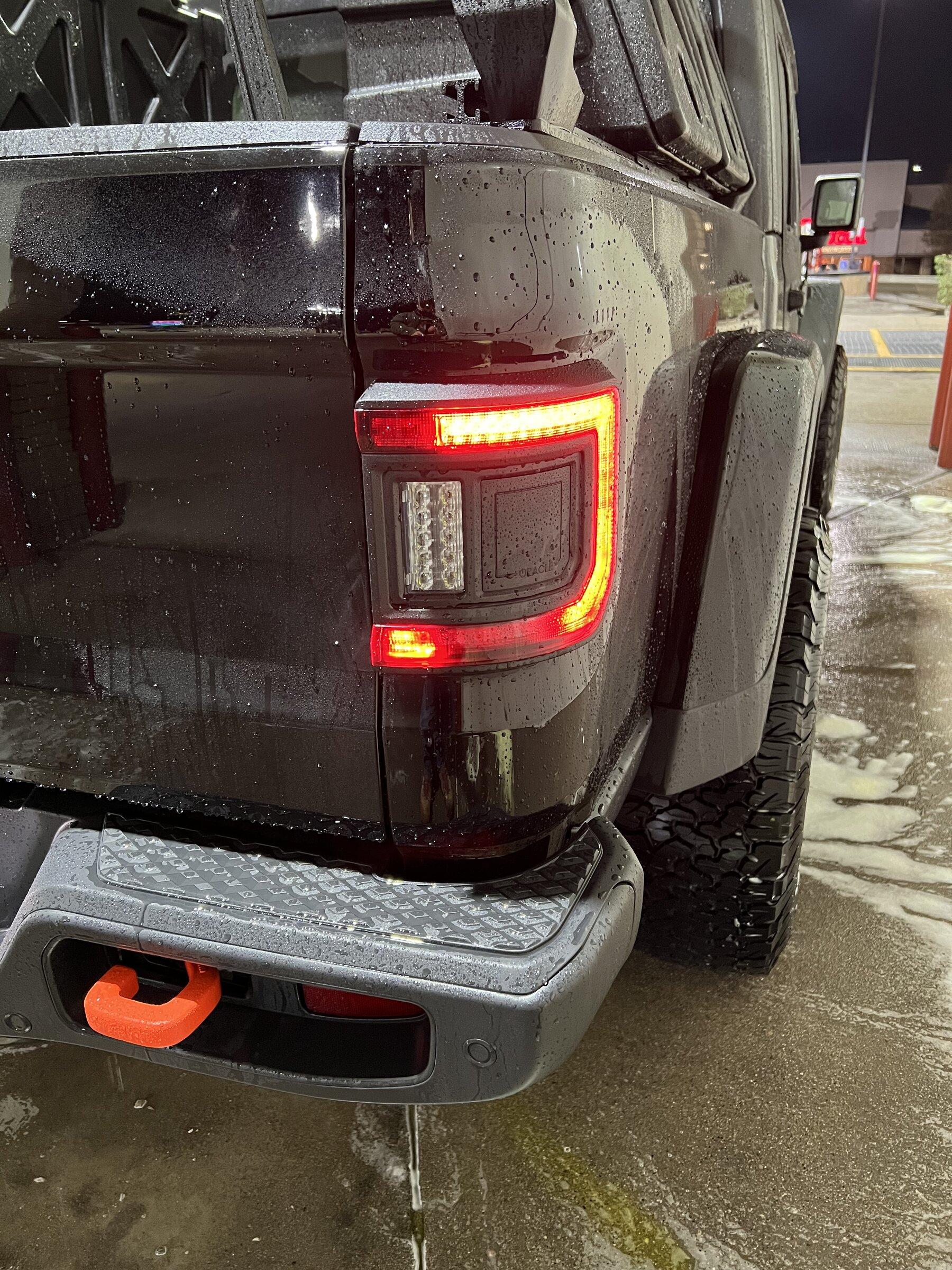

I've had the same issue, just the left reverse staying on all the time. Discovered this when I was stuck in traffic at night and apparently blinding the car behind me. It's not an all the time issue, but now that I'm aware of it I have seen it happen now on a couple occasions. I'll reseat the connector to see if that helps.
Also I still time to time get the turn signal out msg even after doing the correct steps with my Tazer. If it does happen, usually after a couple minutes it I guess "resets" and isn't an issue again.
All of these problems with their product really justifies reporting to the Better Business Bureau. Oracle is basically lying and ripping off their customers which is substandard product and perhaps hitting them with appropriate BBB complaints might make a difference.
Highly likely you need to update your Tazer. I've talked to a couple people experiencing this who needed to do so.

If you have a Tazr installed and you hit your unlock 3 times your left reverse light will come on. You have to lock it to clear it.

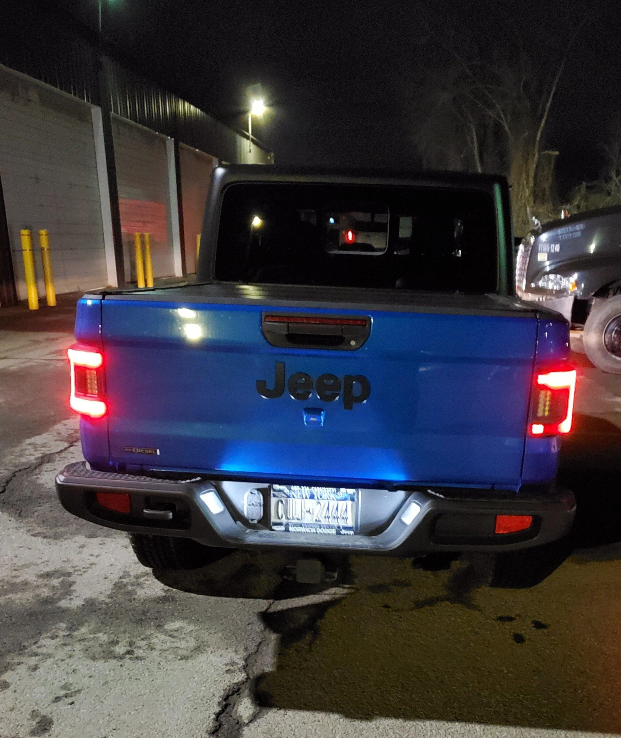

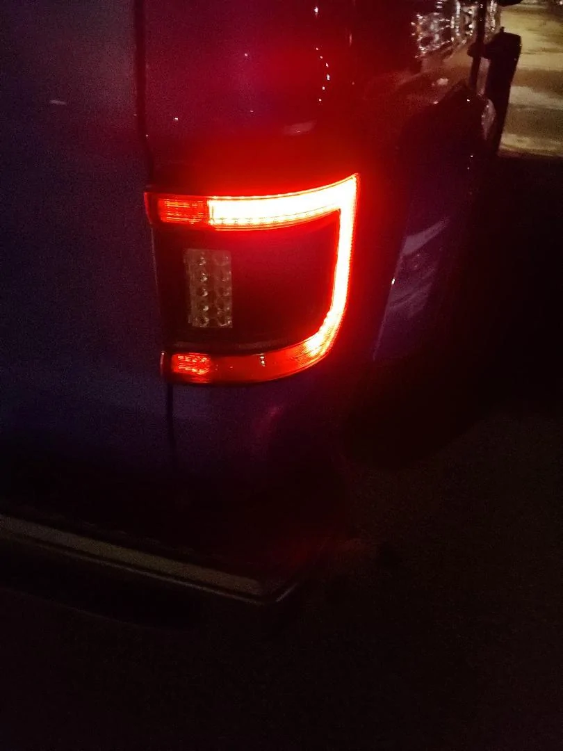

Anyone have this issue? Only portions of my tail light is working. Any suggestions? @ORACLElights
Hello, I'm sorry to hear you're having an issue with your product. Please take a moment to fill out our online warranty request here: https://www.oraclelights.com/RMA and someone from our customer service department will be in contact with you shortly. Thank you!
