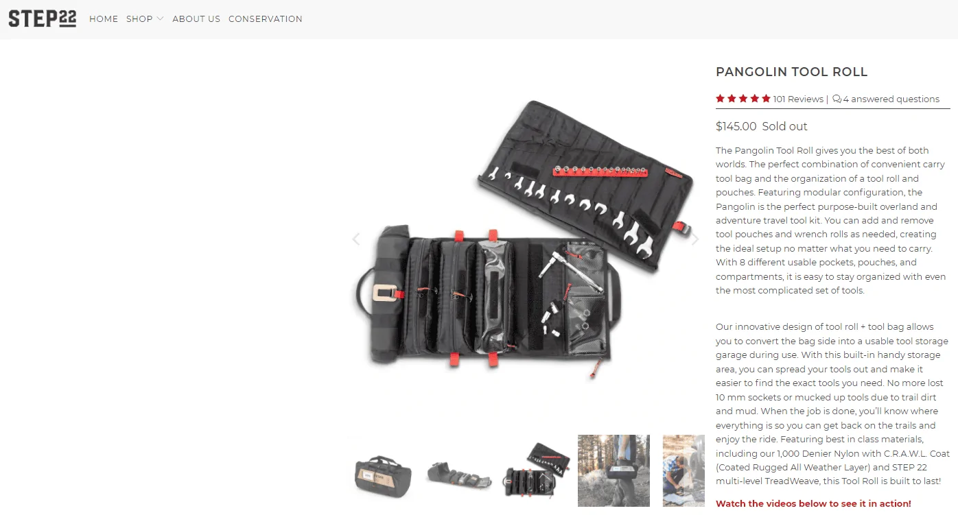

I'm happy to comment on the tool storage solution itself as others have chimed in with the "what" to bring. This Step 22 tool roll is by far my favorite recovery bag. It fits way more than you think and it stows perfectly under the rear seat. I've got it loaded to the gills and I bet it weighs 30lb. With a focus on minimalism, I really like this one bag solution as it works for me. There's definitely "more" you could probably carry of course.
Jeep Gladiator OVERLAND TOOL & TRAIL FIX (must haves) 1641922114028
