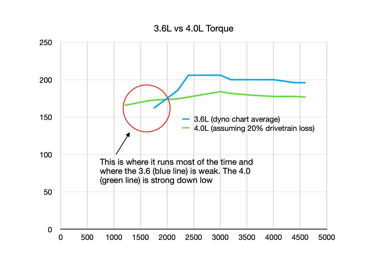

I have yet to see a dyno chart where I trust the numbers at low RPM, which is the area I am most interested in. Maybe it is because all the tests are looking for peak hp and torque and don't care about low end torque. But, if the numbers in that 3.6L chart are to be believed, the torque from the 3.6L drops fast below 2500rpm and falls like a rock below 1700rpm. Considering 1600-2200 is the common rpm range when cruising around, the chart is showing the reason it has to downshift so much.
The 4.0, on the other hand, is still pulling strong down low. The chart you posted makes it look like it drops off fast but that is because the y axis range starts at 140 lb-ft while the one for the 3.6 starts at 0. It exaggerates it. Below is a chart with both of them on the same scale. I assumed 20% drivetrain loss for the 4.0. I left off the part of the 3.6L curve where it falls off a cliff because it is probably not correct.
My takeaway from this is that the 4.0L is torquier (and therefore more powerful) at cruising rpms where the engine is running 90% of the time (or attempts to be) and the 3.6L is more powerful at higher rpms, like when passing or towing up a hill. Not a jaw dropping conclusion. My butt dyno already told me that.
My takeaway from this is that the 4.0L is torquier (and therefore more powerful) at cruising rpms where the engine is running 90% of the time (or attempts to be) and the 3.6L is more powerful at higher rpms. Not a jaw dropping conclusion. My butt dyno already told me that.
Yeah, you are right and most certainly the 4.0 has more torque from off idle to around 1800rpm.
I also agree low rpm dyno testing is infuriating. It gets blamed on the transmission not being able to stay in the 1:1 gear at low rpm or being prone to downshifting, but to me that shows a lack of effort by the dyno owners and operators --find a way to make the trans hold the gear you want, or get a job doing something else very poorly. Dyno testing is essentially data gathering and analysis, i.e. science. This circles directly back to your number chasing comment though. Not many people brag about the torque their engine makes at 1000rpm --that's a very special crowd.
A perhaps more legitimate excuse I've heard is that many transmissions don't make enough line pressure at low RPM to create apply pressure's high enough to prevent slippage. This is plausible and I've seen where torque management routines on RAM Cummins for example, will reduce torque in certain gears and RPMs to allegedly save the driveline.
My JT is a ZF by the way, and I think the converter flashes at near 2000rpm when unlocked, so I don't ever feel the lack of torque under heavy throttle. It seems to be programmed to downshift before it gets called to apply much torque below 1800 rpm. Stated differently, I don't really ever notice my JT operating in the idle to 1800rpm range unless I'm just fatting around town, and then it doesn't matter
