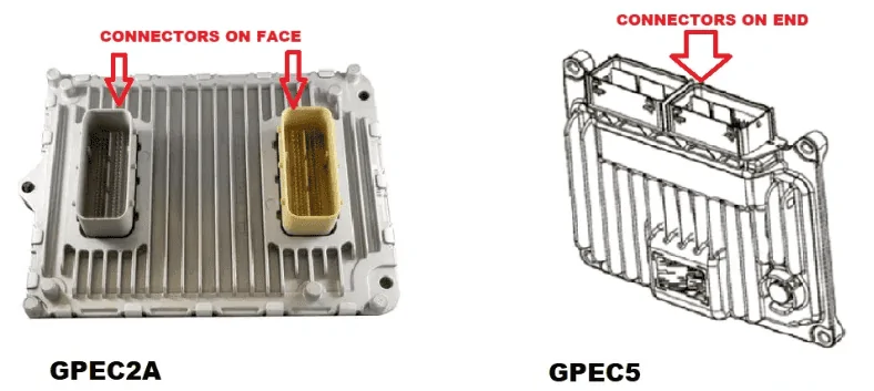

Jeep Gladiator Pentastar power increase PCM-GPEC-compar

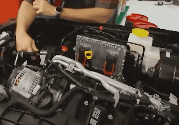

Am I wrong or is this the PCM in that video - and if so, it's a GPEC2A and not a 5
Jeep Gladiator Pentastar power increase PCM-screenshot

Is this the video where someone eventually recognized that it was the 2 and not 5?
At work so I haven't watched the whole video, but how'd they get a 2023 with the gpec2a? The description says they were able to tune the gpec5?
But did THEY post the video or did someone else post it?
If they cracked it then it's out there but you still see company after company saying no, it's not yet cracked.
They may have swapped wiring harnesses and installed a 2A.
I didn't watch the whole thing but recall this video being called out in another forum thread in these forums stating hey, that's not a 5.
look at the picture - is that not the PCM?
Yeah, that is 2A PCM for sure. Maybe the RHD markets get the 2A PCM? I think here in the North American market, the manual Gladiators still get the 2A PCM
