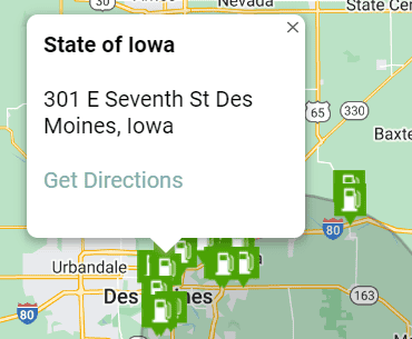

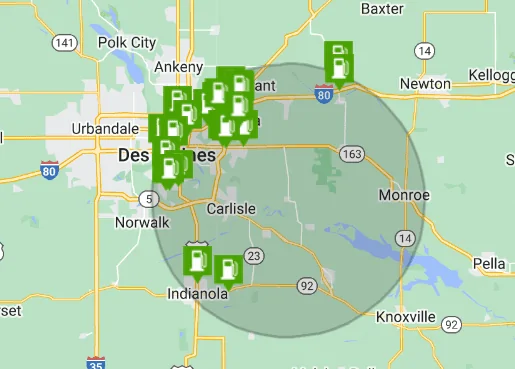

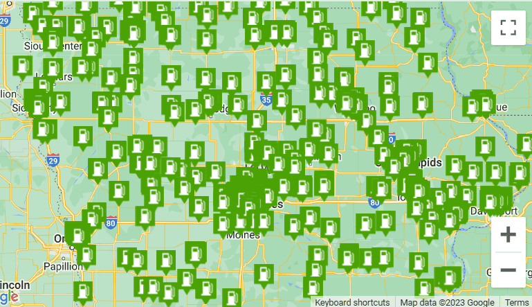

This brings up a dumb question: For the guy who buys all his fuel from either Costco or Farm supply, where does one purchase E85?
Several stations here sell it.
This is Iowa - these are where it and other blends are sold -
Jeep Gladiator Pentastar power increase 1701883280766
This is just within 25km of me -
Jeep Gladiator Pentastar power increase 1701883315745
Pretty much most KwikStar and Kum & Go stations have it.
And of course before I retired - this is where I was required to fuel government cars when returning from trips to the field offices. The problem was, some of those far away, like up in the NE corner of the state - there weren't many gas stations that sold E85.
