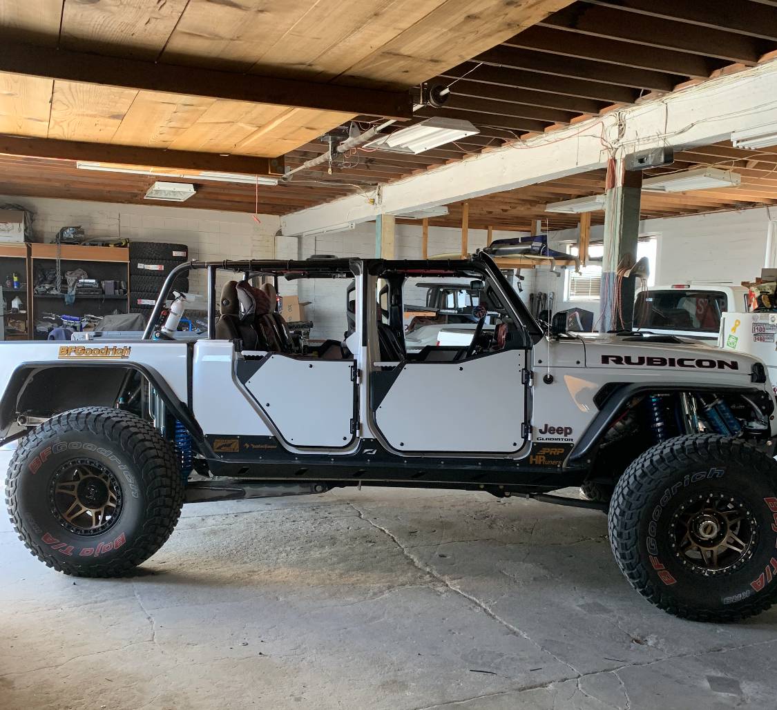

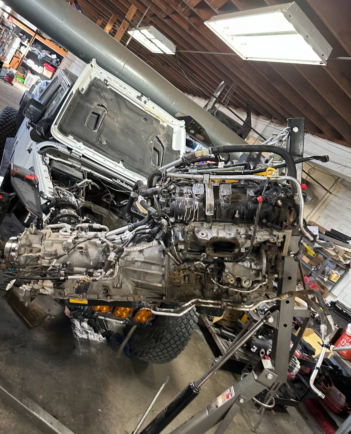

I think it is very unlikely that you could get Houdini to marry up a simplified LS ECU with the sophisticated mess we all have. Nope, sounds good but I'll bet is next to impossible.
Darren Parsons figured it out…
??‍♂ in a home shop in the desert…. Just saying things can be done, even when the internet says no….

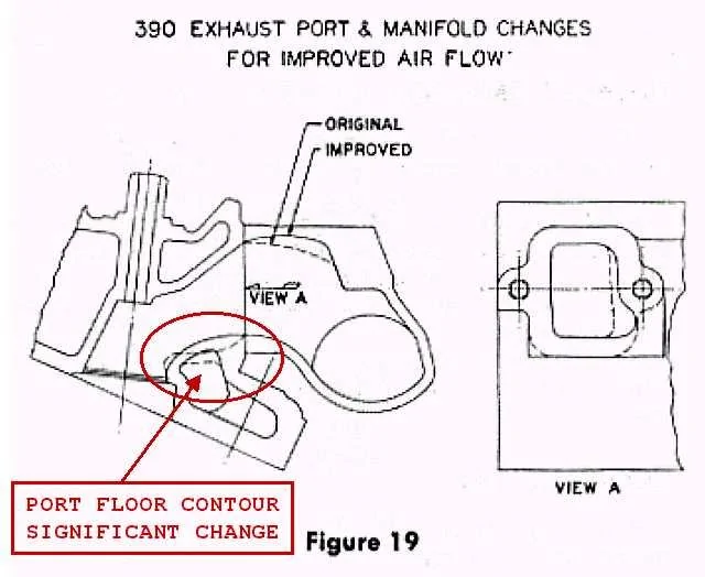

Tune is the place to start for obvious reasons. But for every change you make, you have to look at where the next weakest link is. Changes to the tune can only go so far and then bump into other areas preventing further gains.
Here's an example of how simple shape changes to exhaust ports increased flow roughly 20-25% depending on the valve lift used - the dogleg head design -
Look carefully at what was changed and what wasn't. The floor of the port was changed, the top in another area, but the to the right of the words "VIEW A" was not changed, a clear reduction was not removed.
So opening things up wide in all areas isn't always the answer. Shape matters.
It's called "dog leg" because the port on the head was changed from a rectangle to one with a bump out on the bottom.
3.6l has integral exhaust in the heads. There’s likely no gains from porting as you have a cast style log between the cylinders
