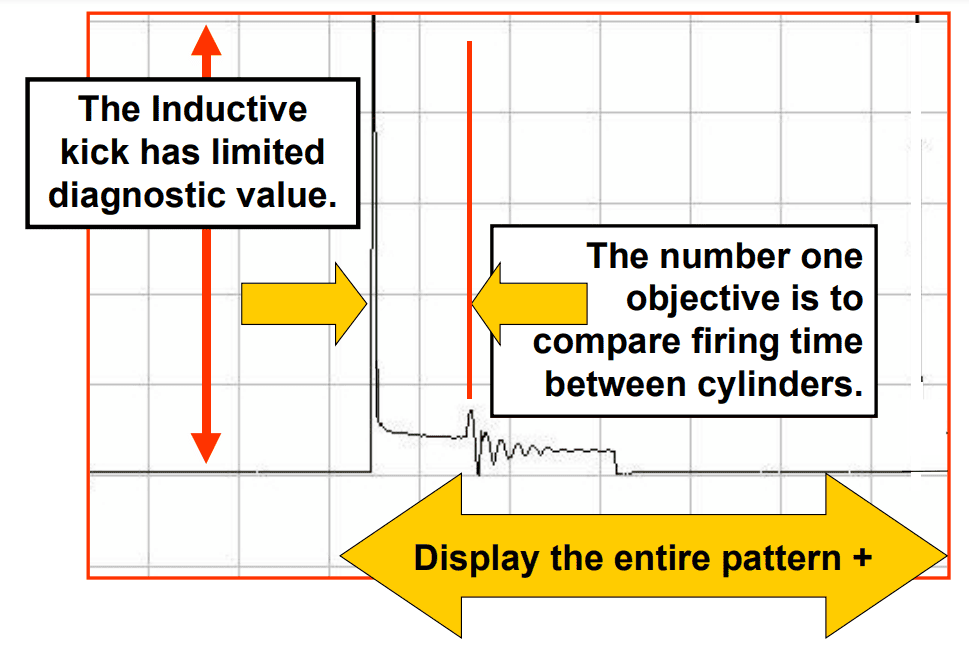

Not picking on you at all - just that I cut my teeth on use of a scope for diagnostics. I've compared many plugs, wires and coils on older vehicles, and the same principals apply to modern, just more difficult to gather the information due to the modern ignition systems.
I see over and over people talk of "I put this on my car and it starts better, idles better......... on and on......." and what's happening is that their engine needs work, if they actually fixed the fuel system, or the physical condition, they'd have the same results.
For those wondering about MSD, if anyone is at all - Multiple Spark Discharge is where the name came from. Instead of one long, fading spark, it supplies more of a zap-zap-zap in very quick succession in case the first one missed the fuel molecules. A standard spark jumps until the energy in the coil is dissipated and then fades and cuts off.
Primary pattern.........
Jeep Gladiator Pentastar power increase 1701627212163
The secondary pattern should show a bit of a nose at the end of the spark interval, slight jump up before dropping off into oscillations
If the spark duration pattern ramps up as the plug fires, generally means an excessively lean cylinder.
A "hotter coil" will generally not be much if any different in the pattern except perhaps in duration, but it won't be higher voltage or a hotter spark. Likely more residual energy dissipated through oscillations after the spark.
From a coil-on-plug diagnostic document -

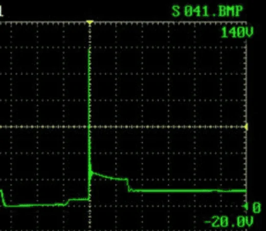

Jeep Gladiator Pentastar power increase 1701627855626
You can tell a lot about the fuel, physical condition of the engine, and more, by comparing the pattern of each cylinder.
