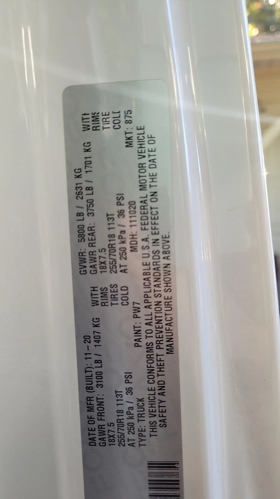

What is the consensus on build dates for this issue? I saw I believe 09/20-02/21 in the thread but that was early on.
JoseQ_80
Jose
Nov 19, 2020
464
743
VA
2021 Gladiator Sport 80th Anniversary Bright White
Highway Engineer

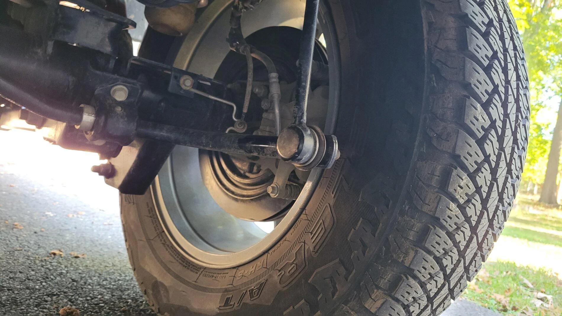

Bld 11/20/20. 80th Anniversary.
No leaks

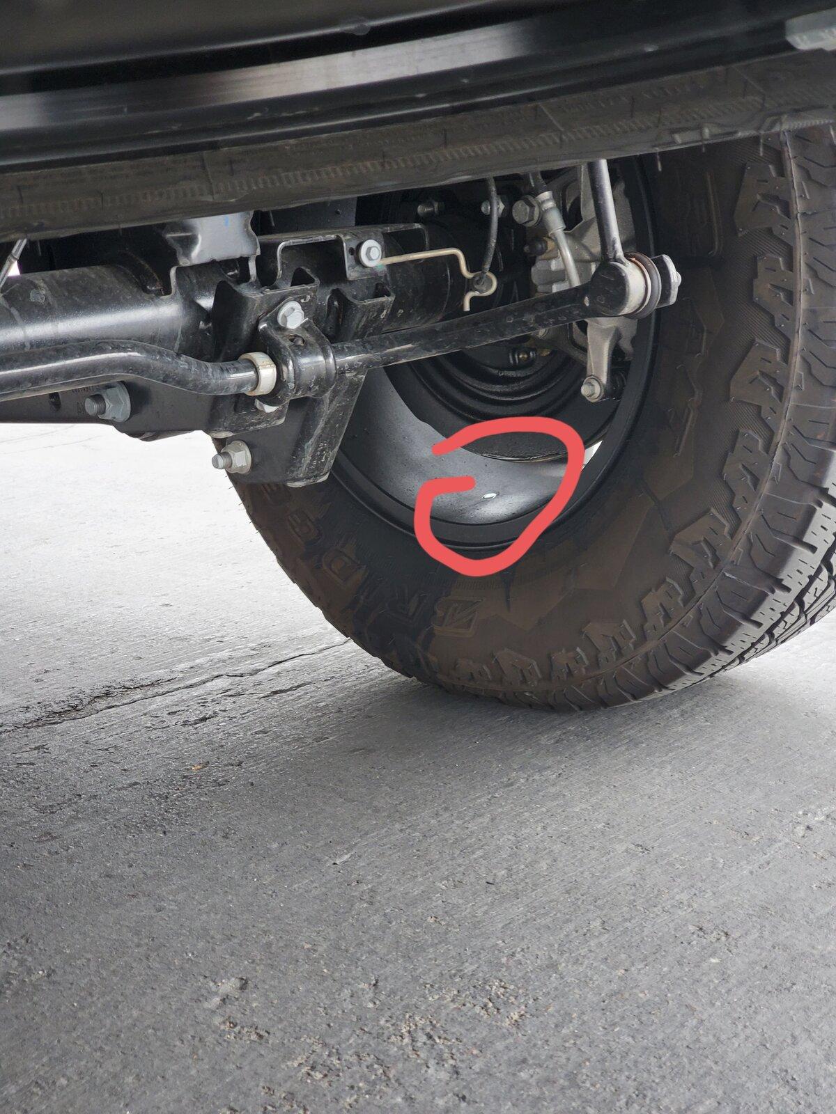

What say you guys about this spot? I believe I fall into the build dates range. Did anyone with this issue experience it causing a knocking noise?
Jeep Gladiator Poll: All 2021 Owners Please Vote Here: Has Your RR Axle Seal Leaked? 20210927_164146
WXman
Mar 1, 2017
69
3,102
4,083
Bluegrass region of Kentucky
Latest build date we've seen so far is 5-26-21.
Mine was built 5-27-21. I'm working toward 7,000 on the odometer now and I've towed pretty heavy with the truck and I have zero axle leaks. Bone dry.
I will mention that literally as soon as I pulled into the driveway after taking delivery of mine, I modified the vent tube cap to allow easier flow of pressure. Is that why I have no leak? Can't say, but it sure didn't hurt. The rear vent tube is plugged up like a wine bottle on these things from the factory. Ridiculous.
